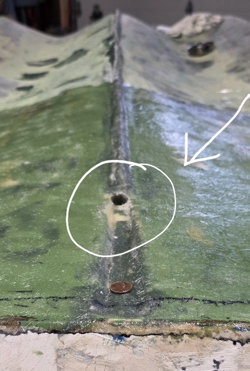

The Drain is in the [hull] bottom [and cockpit deck] towards the stern. See Figure 1.
Figure 1. View of inverted hull showing drain exit on the hull bottom near the transom.
20260711_195119 v2.jpg (113.84 KiB) Viewed 1213 times

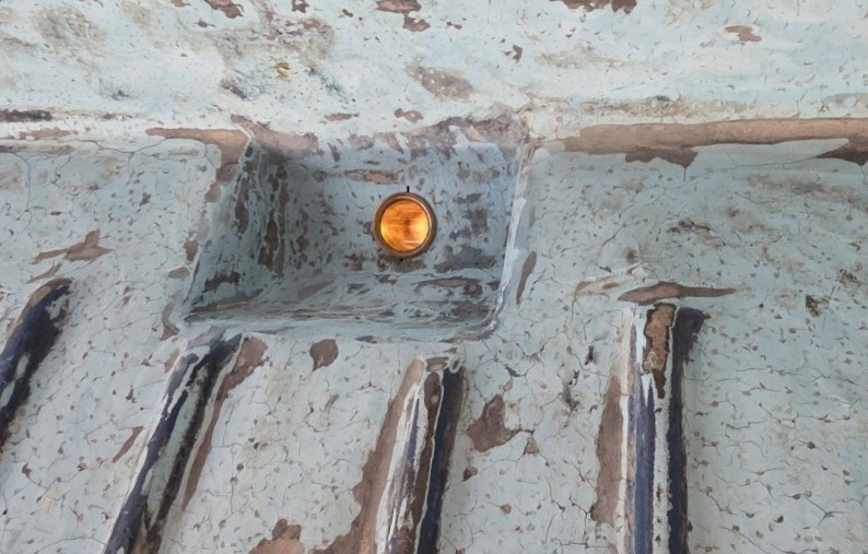

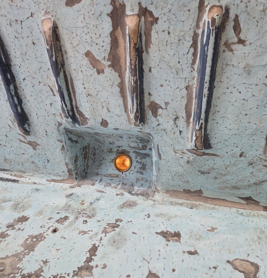

Fig. 2. The drain as seen from the cockpit. [The orientation of this image is very confusing. The drain is supposed to pass through the hull to the bottom. but in this images the drain looks very oddly placed, as if the drain passes through the transom, not the hull bottom.]
Fig. 3. The original image from Figure 2 rotated so that the view now appears to be a cockpit sump area with a drain forward from the transom.
[Moderator's note: please indicate which illustration (Figure 2 or Figure 3) best shows the drain location.
