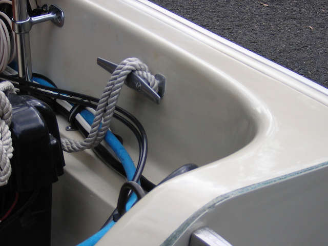

The aversion to gunwale topside cleats also seen on the classic OUTRAGE hulls, where typically there were stern cleats but they were mounted to the cockpit bulwark below the gunwales, and a hawsepipe fitting, flush mounted on the gunwales, allowed mooring lines to be led to the lower mounted cleats.
When I owned a SPORT 15 I installed horn cleats on the cockpit bulwark below the gunwales to facilitate attachment of fenders or for temporary mooring lines.
Fig. 1. A stern cleat mounted below the gunwales in the stern cockpit, and used for temporary mooring lines on a SPORT 15.
For the cleats on your MONTAUK 17, you should consult the wood locating diagram to see if there is appropriate embedded wood reinforcement below the hull laminate at the location of those cleats. Without being fastened into embedded wood reinforcement, the fastening of those cleats to the hull may not be particularly strong enough to be used as a mooring line. That aspect of their functionality would be more important than a classic aesthetic violation.
