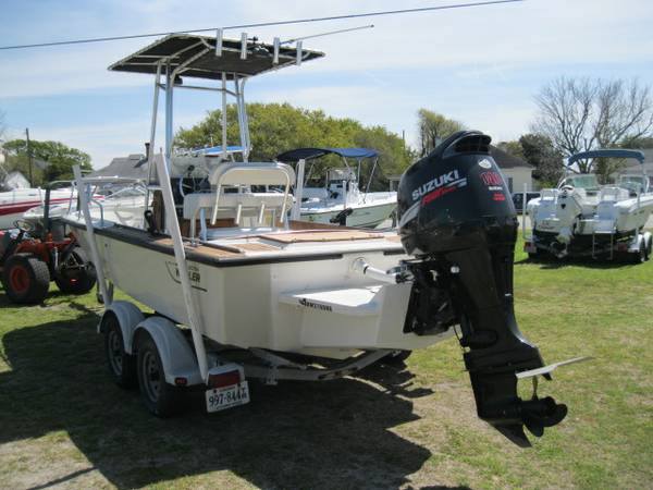

This was recently on Craigslist for sale. I really like the Armstrong bracket on the transom for this SeaDrive 18. Though I was they had done a better job color matching the transom work..
