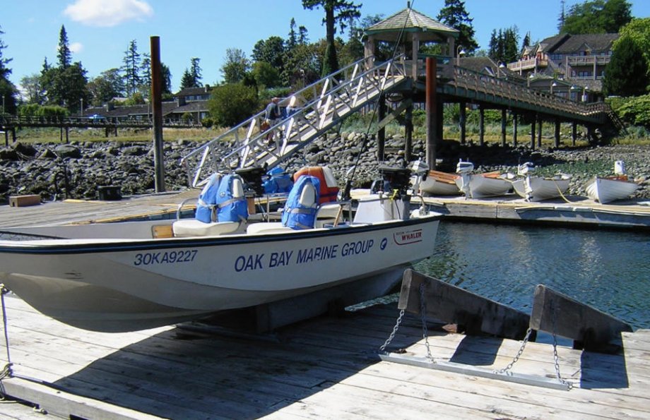

If the hull your have was originally owned and used at a well-known fishing lodge on Vancouver Island, it probably was built as a custom commercial hull. For example, it could a boat previously owned by the OAK BAY MARINE GROUP and used for guided fishing tours. As I recall, when I visited the April Point Lodge in c.2003 they had a fleet of custom-built 17-foot Boston Whaler boats. See Figure 1 below.
Fig. 1. A custom-ordered 17-foot Boston Whaler hull seen in 2003 at the April Point Lodge on Vancouver Island. Photo by the author.
There was no center console on these boats. This would explain why the boat you may have, although a 17-footer, lacks the OEM center console that was associated with the 17-foot hull being built as a MONTAUK model. Note that the model designation is seldom encoded in the federal hull identification number; only the hull length is encoded in most cases.
