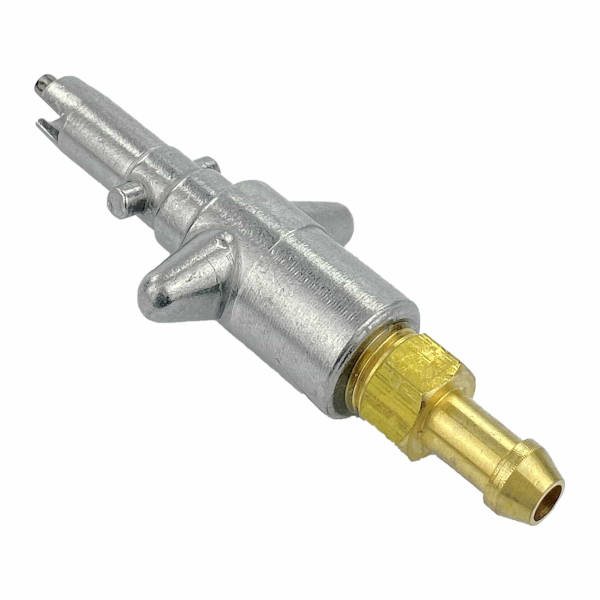

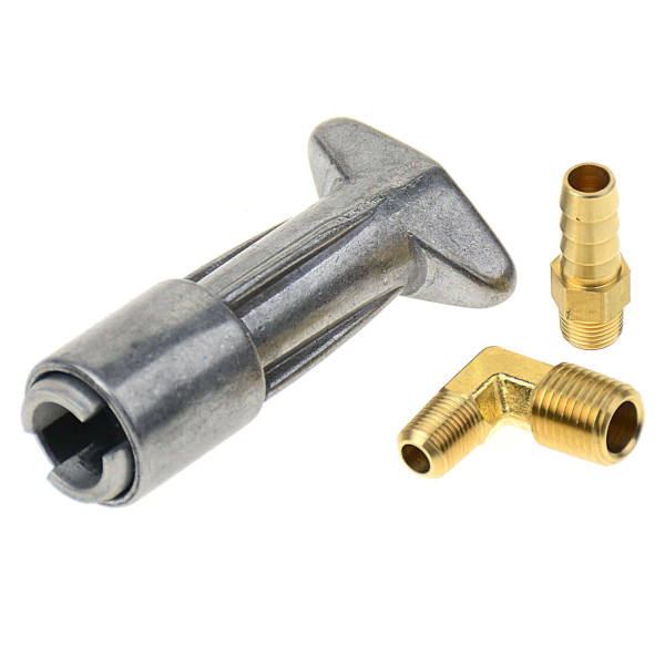

Also, if the fuel hose connection to the engine is not done with a removable connector, you could install an in-line connector at the fuel tank end of the hose, and have a mating connector on the both the primary and secondary fuel tanks. In this way you would use one fuel hose (and primer bulb and inline fuel filter) and move it between two fuel tanks.
The older-style Mercury Marine fuel connector might be useful for this.
Fig. 1. Attach this female fitting to each fuel tank using the brass elbow.
Fig. 2. Attach this male fitting to the fuel hose coming from the engine.

Many years ago I had a 1976 Mercury 50-HP engine that used this fuel fitting. It was a very good fuel fitting. The fit was excellent and never leaked a drop of fuel. These fittings are made of metal and will last forever.
Using one hose for both tanks means there won't be redundancy in the hose (or the primer bulb). If a problem in the hose stops the engine from running, you won't fix it by changing to a different tank.
