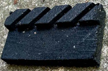

Figures 5 and 6 below show my attempt to improve fuel tank mounting.
Fig. 5. A rubber cleat.
Fig. 6. Tank held in place by rubber cleat.
I made cleats out of leftover rubber strips I had on hand. I cut them to roughly 2-inches x 3-inches, and made a lip to keep the tank from sliding aft.
I adhered the cleats to the deck with 3M4200, because I did not want any additional penetrations in the deckl. I don't have much experience with 3M4200, and I do not know how strong the bond between rubber and fiberglass will be. The front three-quarters of the tank is sitting on DryDek mats that extends to the center console, so the aft side cleats help to keep the tank at an even deck level.
ASIDE: the rope remains in place until the 3M4200 fully cures.

I was hoping for feedback on the cleats.
You had mentioned earlier that rubber and metal in contact can sometimes cause problems.
Q3; what is the adhesive strength of 3M 4200 for this application?
Thanks for all the previous feedback.
Re: MONTAUK 17: RPS or Leaning Post
Posted: Tue Jul 07, 2026 9:26 am
by jimh
ddqarch wrote:I was hoping for feedback on the cleats.
I think you will be the first to know how your rubber cleats will work out in the long run. I don't have any basis from my own experience to offer advice. It does seem like a novel solution.
ddqarch wrote:You had mentioned earlier that rubber and metal in contact can sometimes cause problems.
The continuing presence of water held in a rubber spacer that touches the aluminum metal of a fuel tank when the fuel tank is in a closed-off cavity has been suspected to cause pits and erosion in the aluminum. The rubber cleats you have are going to be continually exposed to air so they should dry out rapidly if they get wet.
ddqarch wrote:Q3; what is the adhesive strength of 3M4200 for this application?
I think you will be the first to know. I don't have any basis from my own experience to offer an opinion. About all I can say about 3M4200 is that it is supposedly less permanent than 3M5200.
