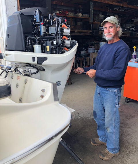

Jerry instructed me to back the boat up to the big garage door of the workshop. I got the "good" sign when I had pushed the boat into the garage opening just far enough to get the leg of the engine into the shop proper. Bill, the 30-year-veteran Evinrude mechanic, was all set to service the water pump.
A short lunch break at noon interrupted things, but by about 2:30 p.m. the engine was back together. It had even been water tested for proper water pressure output at the local launch ramp, very conveniently almost next door at The Forks launch site on the Cheboygan River.
Fig. 1. Chief mechanic Bill buttoning-up the side panels on the engine at 2:19 p.m.
