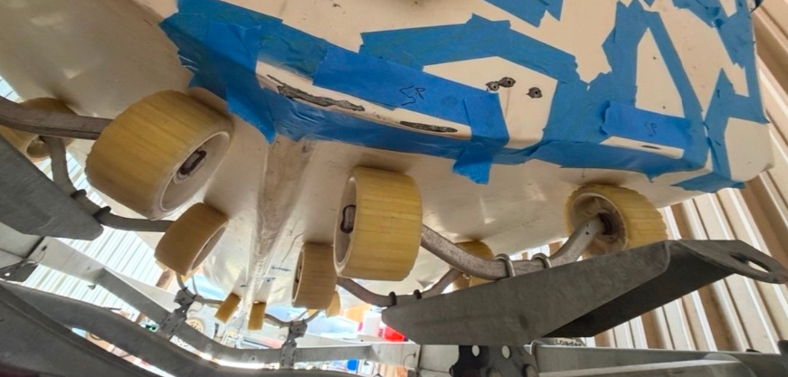

The principal concern is the hull of a Boston Whaler is constructed with a unique method--the Unibond Hull method--and the hull laminate layup is relatively thin, except at the keel. Most of the weight of a Boston Whaler boat kept on a trailer should be supported by keel rollers, or a combination of keel rollers and bunks. Boston Whaler used to be quite emphatic about this approach, but at some point they seem to have stopped insisting trailers must have keel rollers carrying most of the weight. The floppy-roller trailer design has never really been used or blessed by Boston Whaler. The concern is that too much force could be concentrated on a small area and possibly cause a deflection of the hull laminate.

Fig. 1. A Unibond Hull being carried on a floppy-roller trailer. Note how hull damaged areas seem to align with the position of the floppy rollers. Trailers of this type are not suggested for use with Unibond hulls.

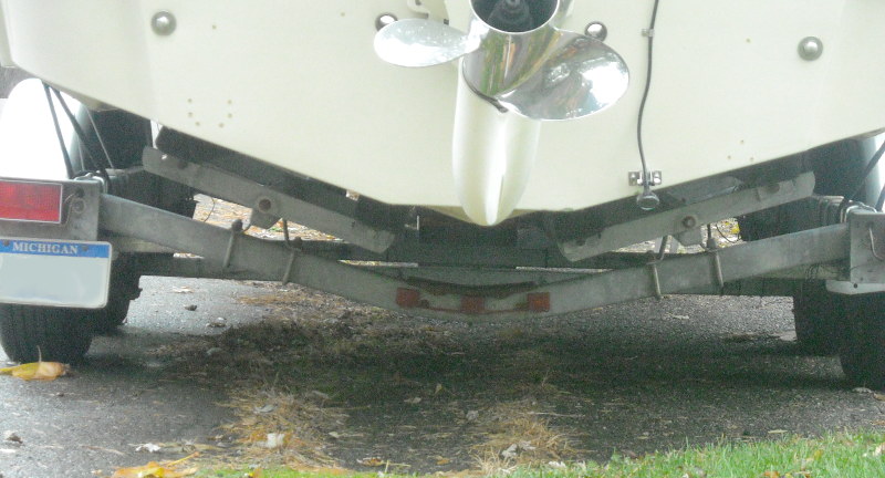

My own 22-foot hull has lived on a trailer with keel rollers supporting for forward half of the hull on the keel, and two sets of twin-bunks that self adjust to the hull supporting the stern half of the boat, with one of the bunks near the keel and the other bunk in the set about three feet outward.
Fig. 2. Trailer for REVENGE 22 W-T Whaler Drive with adjusting twin bunks supporting stern of the hull.

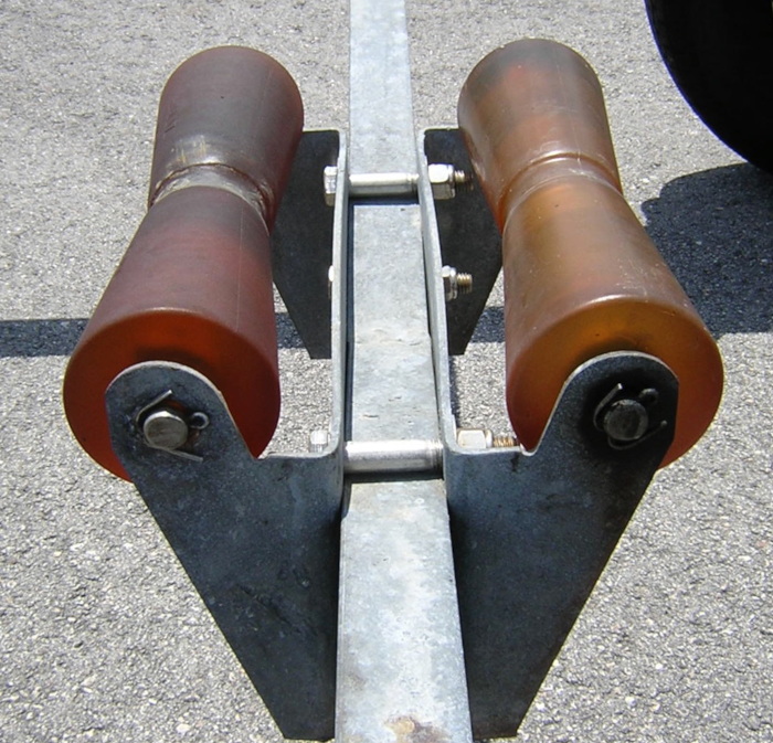

Fig. 3. Tandem keel rollers straddle a trailer crossmember. Note the stainless steel axle rod with drilled holes for cotter pin retainers. The roller material is polyethelyne with a steel center tube.
