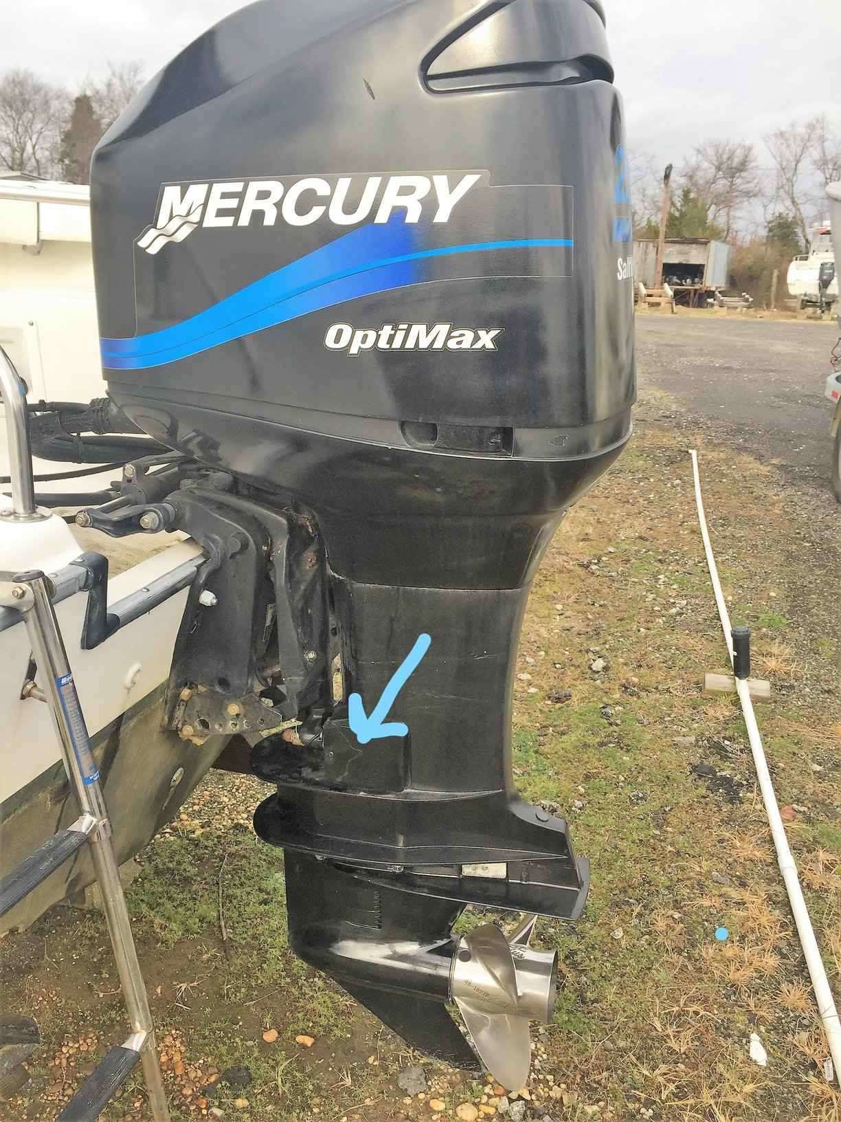

- rsz_16197413_0_130420170654_11_li.jpg (245.92 KiB) Viewed 15801 times
Re: 2001 21 OUTRAGE: Fair Price
I would certainly think not.
Still like the boat? Adjust the offer to what you can afford along with the affordability of replacing the outboard.
Could be the cost of that repair is why the boat is up for sale.

The crack might be just in a small cover plate, which might be plastic. Ask a proper OptiMax mechanic for advice.

It appears to be a cover plate that hides a bolt mounted under it. Have to get a closer look to be certain the mount under the plate is good.
The appearance of the engine is indicative of a boat kept in the water without tilting the engine to the full up position after use. It does not necessarily do any harm but does not help the looks. When our boats are kept in the water we tilt the engine up after use and flush with fresh water followed by a spray rinse.

Haven't seen in person - just been trading emails and pictures with owner. Sent picture of motor to Mercury repair near me and they believe If that plastic housing is cracked most likely the motor mounts are bad. If that's the case, it would be a $2-$3 thousand dollar repair. At this point, owner isn't being real forthcoming with information and he doesn't appear ready to come off his asking price.
