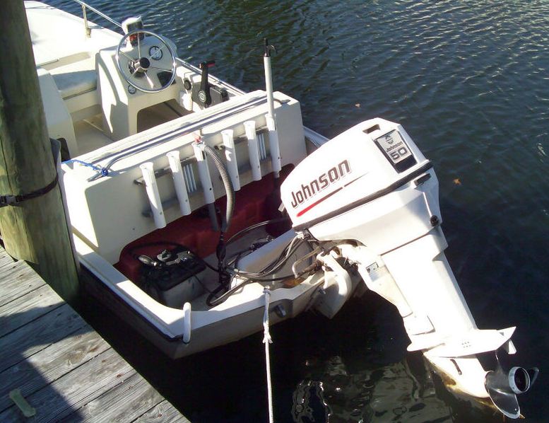

Hi, I have a 1988 13 super sport limited and I have (I think) 16 gallon tank under the rear seat, tight but it works
whaler 12.JPG (94.05 KiB) Viewed 31846 times
Ron
