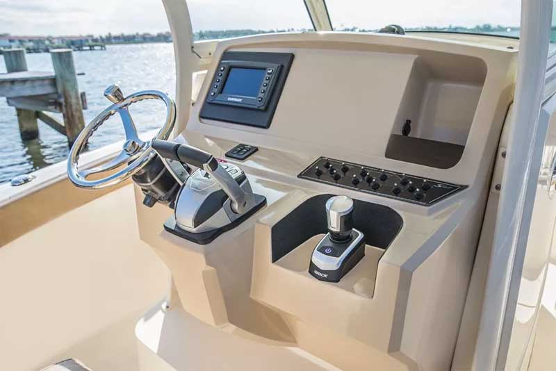

Evinrude showed the new iDock installed on a SCOUT boat's helm (and probably the same boat as demonstrated in the presentation):
The joystick controller is the only visible component of the system, as the two black boxes are tucked away out of sight and appear to be rather small in comparison to other versions of joystick steering that are implemented with external hydraulic boost pumps. There is an icon on the base of the joystick with the universal ON-OFF meaning, and other than the joystick with rotary knob, that appears to be the only control.The icon illuminates when the iDock is active. Based on some reports from first-hand users who were able to test a prototype of the product several months ago, when the joystick is moved beyond an initial detent in the motion range, the engine RPM will increase to provide more thrust; this may be needed in maneuvers being made in strong winds or with current effects at the dock.
