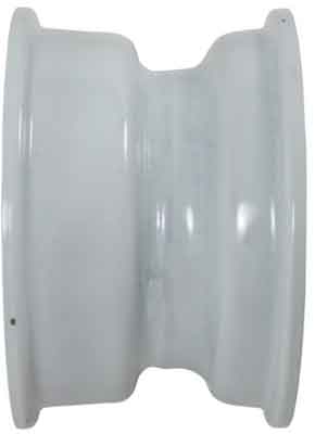

I like the idea of using PVC pipe as a railing system--it won't float. Are there any common trailer wheels that, without tires on them, would run on 6-inch PVC pipe as a rail-guide or trolleyway?
Here is a view of a 10-inch diameter trailer wheel. The rim is 6-inches wide. It looks like it would run on some appropriate diameter pipe:
What is the difference between ABS pipe and PVC pipe? How to their strengths compare? How does the cost compare?
