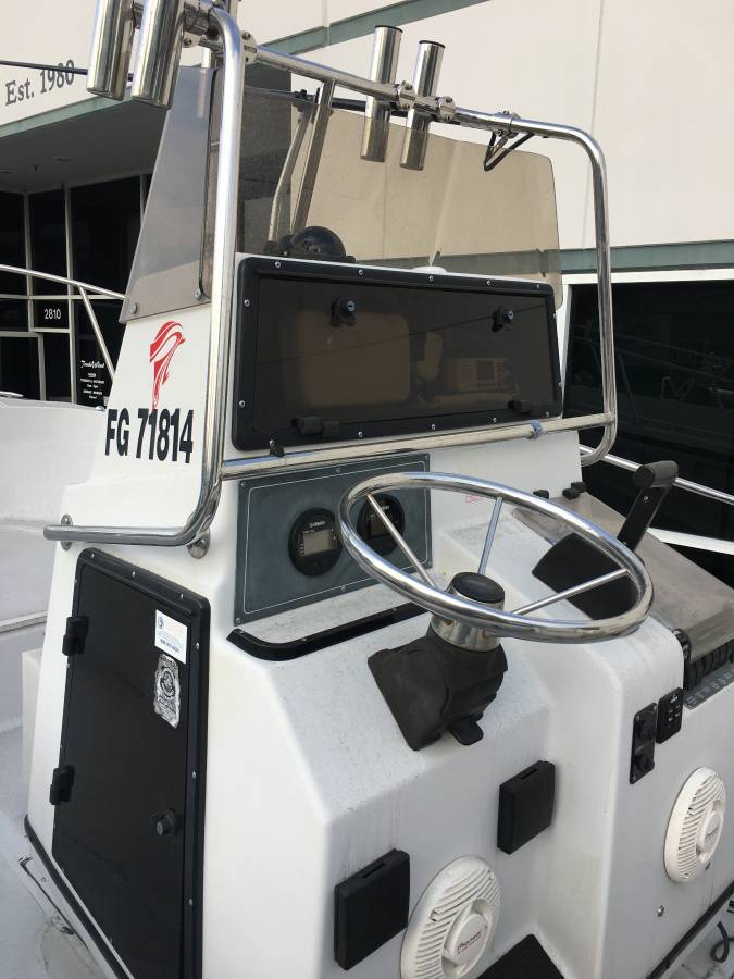

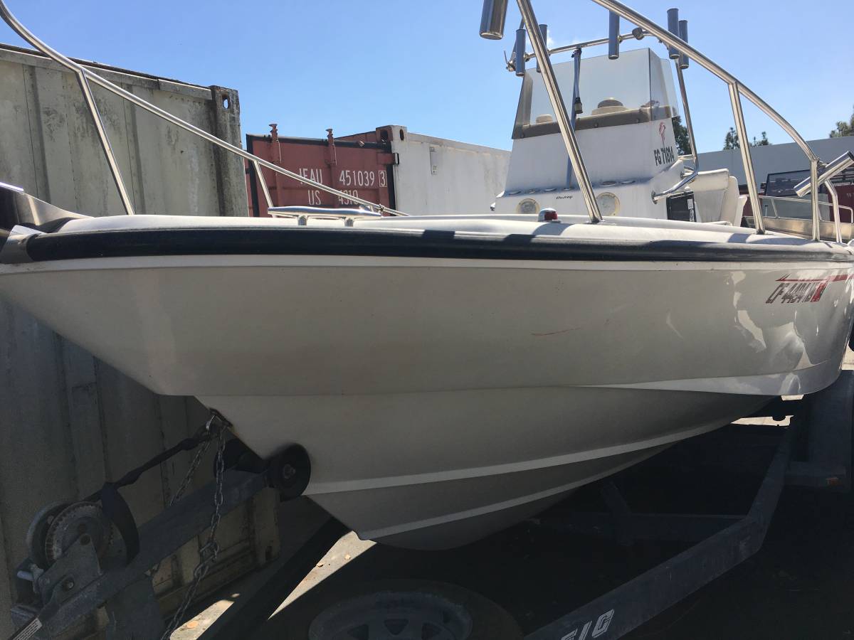

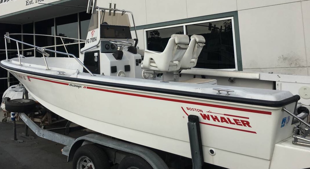

Here are some pics:
It’s gonna be repowered with Honda F225 with 400-hours. Also it has an aluminum tank that has been pressure tested. It doesn’t have a T-Top. They are asking $25,000-- is that a fair price?

[The 1996 21 OUTRAGE is] not a bad looking boat and seems well maintained.
Most Whalers have a wooden reinforced transom, but if the drive you show was installed correctly and no extra holes for accessories were added (anywhere on the hull).
You don't need to worry about water logging.
With no motor currently it might be a good idea to weigh the boat which could tell you if you have or have not any water in the hull.
From what I know this is not what is called in later years "AccuTrac".
A good no feed back steering set up should keep you reasonably tracking on course.
The $25,000 to me is high for a 21-year-old boat with the used to-be-installed engine.

Yes, ALL Boston Whaler boats are build with a double-bottom hull with a foam filled interior. Any underwater penetration of the hull that has not been immediately and properly repaired could allow water to enter the sealed double-bottom hull and begin to saturate the foam. See the FAQ for more remarks. http://continuouswave.com/whaler/reference/FAQ/#Q3 The FAQ will provide you with a very comprehensive, well-researched, and thorough discussion of the problem of water retention in the interior foam of a Boston Whaler Unibond hull. I very strongly suggest you read the FAQ, and also read all of the FAQ in order to become more aware of common concerns about Boston Whaler boats.
Fordcustm wrote:Specific areas to pay attention to when looking at it?
There is nothing about a Boston Whaler boat that causes there to be specific areas to inspect other than the already mentioned risk for concealed water intrusion and damage it has caused. For general advice on buying an older Boston Whaler boat, read:

The boat has some unusual registration number (FG71814) which suggests to me that it is not in the USA. Where is the boat located? The price of used Boston Whaler boats tends to vary with location. WIthout knowing where the boat is located, assessing the asking price is unlikely to be possible. If the boat were local to me here in Michigan and I was buying it at this time of the year and with a used outboard engine, I would not pay $25,000 for it unless the boat was in absolutely perfect condition, the used engine was similarly in great condition, I had great trust and faith in the seller or the dealer representing the boat, and I absolutely had to get that boat for some reason. In short, the $25,000 sounds like a bit higher than normal price.

Jim, you can see another hull registration number on the port bow, start with a CF, not sure what that additional number on the boat designates.

FG is a country code for French Guiana.
CF is a state registration code for California.
I don't know what basis to interpret the two codes to know the boat's location at this moment, and that is why I asked the OP this question:

I went to Yacht World and saw four similar boats in the $16000 to $18000 range. This one seems to be in good condition. I noticed the ice chest cooler behind the seats. And I also noticed that there's some kind of a box or contraption in front of the center console where the ice chest was originally placed by Whaler. I'm not sure what that is. Maybe a place for a subwoofer? The boat seems to have enough speakers to run a floating discoteque. I would also say that this boat did not have any of the fishing packages. Under the toggle switches, that speaker is where I would have expected the three tackle trays included in either of the two fishing packages that were offered by Whaler. I also noticed 2 gunwale rod holders instead of 4. I would honestly say maybe $17,000 would be where I would try to get the price down to. I would also add that at $17,000, or the $20,000 that I got for mine is pretty good for a boat that is 21 plus years old. A tribute to how well these were made. I know that the dollars are not the same but I paid approximately $40000 for mine in 1994 and got $20,000 23 years later. Not bad for a boat with thousands of hours on the ocean.

The FG designates a California commercial fishing vessel.
Sequentially numbered, this boat started commercial fishing somewhere around 2013.

Many thanks for the clarification regarding the meaning of the prominent number FG71814 displayed on the boat. A buyer making a decision to purchase the boat would certainly want to be informed that the boat had been in use in commercial fishing.

You'd never have guessed it was used commercially from the pics, pretty clean looking unit.
