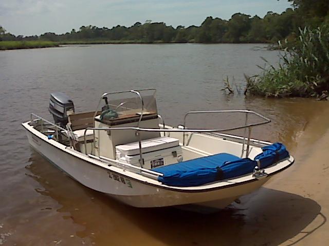

I want to put a top on my Montauk 17 that is used nine time out of ten for angling, and I don’t want the top to get in the way. I found [a top pictured below] that seems like a good idea-- but how then do you use the anchor?
Where can [a Bimini top on a frame that stows forward and has the hinge bases mounted on moveable tracks, as] shown in the attached image be found?
The reason for getting a top is in case the weather turns: the top will give me cover; it also will give protection from the sun.
MONTAUK 17 Top

You have two choices; buy [a top for a MONTAUK 17] from Mills or have one custom made by a local canvas shop that's close to you.
Examining the image, it looks like the pivot point on the hull allows for the canvas to slid forward and fold down just forward of the bow rail assembly. I don't know if that's a standard Mills setup or not. It looks decent. There could be other ways to secure the top that would be out of the way
Accessing the anchor locker would not be a problem, just move what looks like a cushion over the locker, and run the line under the canvas to the anchor line cleat.

dleopoldi914 wrote:...Where can [a Bimini top on a frame that stows forward and has the hinge bases mounted on moveable tracks, as] shown in the attached image be found?
A generic Bimini Top can be found at many vendors or sold directly by some manufacturers to the customer via on-line sales. These off-the-shelf products are about $300, or about one-third the cost of a Wm. J. Mills & Co. top, now probably at least $900 and perhaps more.
In order to give you more advice, you should mention what sort of budget you have for the canvas project.
A locally made custom fitted top from a high-end canvas fabricator will have a cost equivalent to the Mills, but will include the installation on your boat.
The cost of any boat canvas reflects:
- the material costs for the frame and fittings
- the material costs for the fabric
- the method of fabrication, either standard mass-produced design or bespoke design with artisan fabrication
- the location of the manufacturer or shop
- the general market for boating canvas
High-quality marine-grade stainless steel tubing costs more than aluminum tubing; it is also harder to work with and bend.
Certain fabrics have extremely good track records for use with boat canvas. A material like the Glen Ravin Mills SUNBRELLA fabric will be more expensive than some no-name plastic infused cloth.
Stock designs that are mass produced on a production line basis will be much less expensive than custom-fit products made by true canvas artisans.
Buying a top using plastic and aluminum, some no-name fabric, directly from a manufacturer in some relative low-cost region via on-line will be much less than the buying a top using stainless steel and Sunbrella made as a custom-fit from a highly regarded canvas fabricator located at a waterfront shop in an expensive harbor town.
As the cost of a boat in general increases, the cost of accessories tends to increase proportionally. A new 17-foot Boston Whaler can cost $50,000. That good canvas for that boat might cost $2,500 is not out of line.
