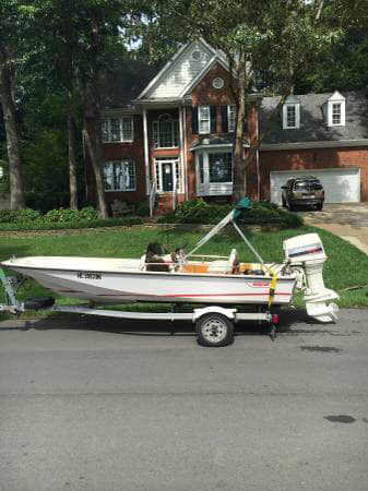

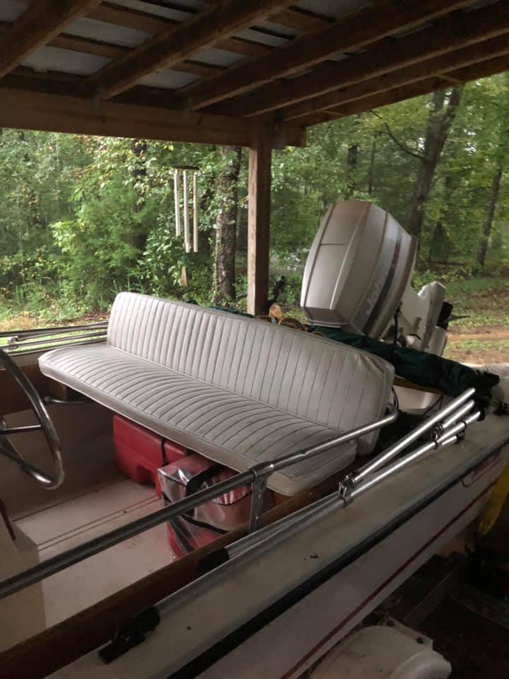

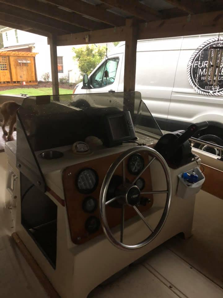

Guess I will post some pics. Guy is out of town for the weekend and I am supposed to have first shot at seeing the boat early next week.

Re: Assessment of c.1984 CENTER CONSOLE 15 with 70-HP
dtmackey wrote:Looked for the 15 center console for a couple years and they all sold very quick and I consider them to be the holy grail of the Whaler 15 models.
I wouldn't hesitate to purchase the one you've shared if it checks out. The John-Rude motors are great motors and simple, but they tend to be a little loud and unrefined and understand your desire for the Yamaha but they are similar in design only. The 15 Whaler I purchased came with a 60 Evinrude (same as 70 with carb tweaks), but I opted for a Yamaha 70 2 stroke. The Yami is the smallest displacement of the 70 motors on the market, but the carbration is far ahead of the John-Rude motors, electronics are more reliable and the are quieter with a more advanced oil injection system with a tank on the motor, so no extra lines and tanks in the boat.
Looking at your response, I will say that the motor is electric start, without a doubt.
I was able to sell the Evinrude 60 on my boat and purchase a Yamaha 70 for almost no money out of pocket with all controls and tach for $1500.
D-
I agree about the rarity of the 15 CC and this draws me to it even more.
Engine noise isn't at the top of my priority list, so I am sure I would run the Johnson for a while. My goal would be to find a deal on a Yamaha, and sell the Johnson, and net out for pretty low cost, like you mentioned. My close friend is a Yamaha marine tech, he has customers upgrading engines all the time and sometimes they let the old engines go super cheap. He recommends the Yamaha's over other brands. He is also a Evinrude/BRP tech and he hates those engines haha. But I am sure I would be happy with the Johnson as long as it is reliable.
Thanks for the response!
