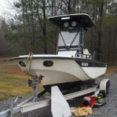

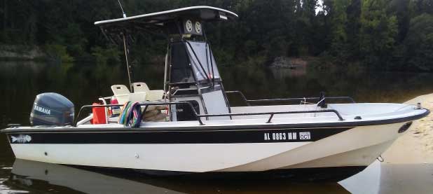

Here is the boat:
Fig. 1 No Caption provided
Fig. 2. No Caption provided
Re: Info on Justice
Postby Phil T » Sat Jan 26, 2019 11:50 am
That is a Guardian model. Based on the classic Outrage 20 or 22 made from mid to late 1980's.
A great boat.
