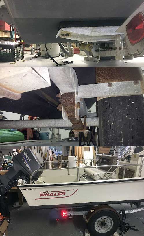

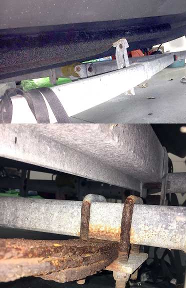

I have a 1992 Montauk 17 with a 30-gallon aluminum fuel tank and a 2008 Yamaha 70. I have owned this boat since 2005 and have been through a lot with it. Now that I have the finances, I am looking to give her a little TLC before we start diving and fishing this season. I have never liked the way that she this MONTAUK 17 on the trailer that I bought her on, and I think the trailer is undersized. My first project is to repair the existing trailer or purchase new, so that I no longer have to sweat while driving to the ramp.
My existing trailer is a 1992 Loadmaster which is rated for 1500-lbs. The load rating is actually the only thing still legible on the original trailer sticker. I have a clean title for the trailer. If my hull weight is around 1000 pounds, plus 210-lbs of fuel, plus about 230-lbs for the engine (from what I can find), that gets boat weight to 1540-lbs. Now add 10-percent for gear and the boat weight is 1694-lbs, over the 1500-lbs limit of the present trailer.
The frame of the trailer is in good shape. It really needs new hardware, leaf springs, bearings, bunks, and possibly an axle. As for the fit this trailer has an overall length of 17 feet. The current setup has the jack stand approximately two feet from the tongue, and the base of the bow stop is approximately two feet aft of the jack stand. At the stern, the distance from the rear crossmember of the trailer to the transom is about 2-feet 3-inches. The bunks stick out past the rear crossmember of the trailer, so the distance between the rear of the bunks and the transom is about 11-inches. The current tongue weight is probably about 75-lbs--a guess. To me, this trailer seems too short for the boat. Also, the hull sits about two-inches over the wheel wells and will rub on the wheel wells from time to time, which I hate.
Fig. 1 Views of various parts of the current trailer.
Fig. 2. More views of various parts of the current trailer.
Q1: Is it possible to make this trailer work?
Q2: Is making the trailer work worth the cost?
On the flip side, I have been shopping around and can buy a new LoadRite bunk trailer for about $1,800 with 2450-lbs capacity and 14-inch tires--as recommended by the Loadrite dealer. I am also going to shop the local Venture dealer.
Q3 Now what to do?
Q4: Can anyone lend some advice?

Cow_Tipper wrote:Q1: Is it possible to make this trailer work?
You should determine if the "1500-lbs" is the maximum total trailer weight or if it is the maximum load weight. Your estimate for a MONTAUK is probably accurate. Usually a trailer rated for about 1,700-lbs of boat load is used.
Cow_Tipper wrote:Q2: Is making the trailer work worth the cost?
Repairing trailers by buying replacement parts at retail prices will probably not be cost effective if you need to replace many components. Some of the problem with the current trailer fit to the boat could be resolved by moving elements of the trailer around. The transom of the hull should be resting on bunks, not overhanging them by a foot. You are going to be refurbishing a trailer that is 27-years old. I bet your costs will be about half the price of a new trailer.
Cow_Tipper wrote:Q3 Now what to do?
Sell the present trailer. Ask $600 and take $500. Buy a larger trailer that better fits the boat. Everything will be new. The boat will fit better. You won't have a trailer problem for at least five years (unless you boat in tropical saltwater).
Cow_Tipper wrote:Q4: Can anyone lend some advice?
See above. You forgot the weight of the boat battery, usually at least 50-lbs,

Cow_Tipper wrote:...the [MONTAUK 17] hull sits about two-inches over the wheel wells and will rub on the wheel wells from time to time...
Usually a trailer with 8-foot 6-inch width will permit a MONTAUK to fit between the fenders. The fenders and the boat should BOTH be in a fixed position when on the trailer. If the boat rubs on the fenders only occasionally, it must be doing so because the boat has been loaded on the trailer off center or tilted side to side.

Jimh, thank you for you insight. Although at one point it seemed like you were hinting at rebuilding the existing trailer, I agree with your summary that a new trailer is in my best interest. My local dealer quoted me for a 2450 lb trailer.

I think the fundamental problems with the existing trailer are its original maximum load rating of only 1,500-lbs, its apparently rather narrow width, and its apparently rather short length. I don't see those problems as being remedied by refurbishing the trailer. Even if you did fit new axles, springs, wheels, and tires so that they could carry a higher weight load, you will not have changed the basic structure of the trailer. A trailer does not get stronger, longer, or wider over 27-years of aging and use.
If you own a trailer boat, your enjoyment of boating is greatly influenced by the process of trailering and launching or loading the boat. If the trailer makes towing or launching and loading or storing the boat difficult, then the enjoyment of boating you will experience will be reduced. The more suitable the boat trailer is for its mission, the more you will enjoy the boat.
