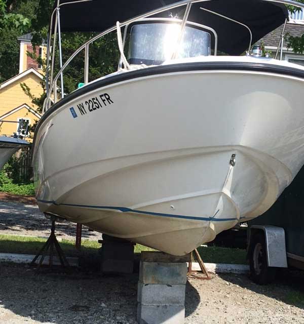

Brought the boat home two weeks ago. The ride back from Geneva, NY to Rye, NY was interesting -- was pushing my Mazda CX9's limits (3500lbs capacity).
Anyway, boat's in great shape. I put it in the water for a week to achieve a 'scum line'. Put a couple hours on it and it has performed great.
It's out of the water now getting bottom painted (for first time) and a 100 hr engine service. I'm also replacing all through hulls (ordered through Nasuat Marine--great service so far); I'm replacing with the (crappy plastic/lego) Whaler/Brunswick units as I could not find a matching aftermarket kit from a company like Perko.

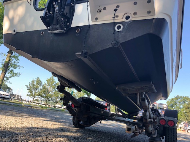

A week in the water produced the scum line.
Here's the 2 coats of epoxy.
Followed by a hard coat (blue) and 2 coats of ablative black.

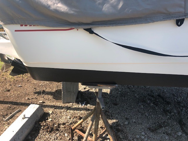

All new through hulls:
4 New through hulls.jpg (92.84 KiB) Viewed 28133 times

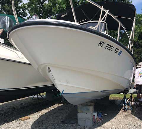

Lifting off the blocks:
5 Almost ready.jpg (116.23 KiB) Viewed 28133 times

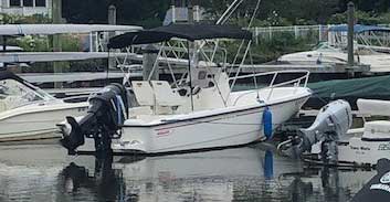

Back at the dock:

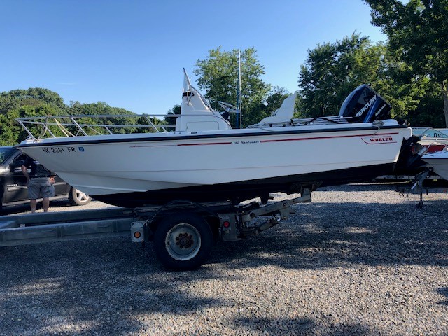

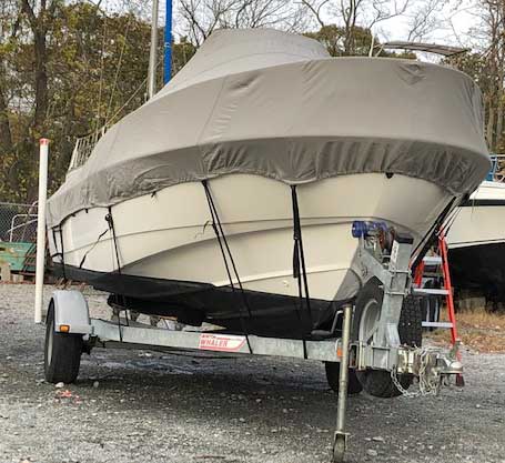

My 2004 Boston Whaler Nantucket/Outrage 190 came out of the water today (November 4, 2019) for the first time since July. It's been cleaned and encapsulated in a few layers of Collinite No. 925 Marine Wax.
190 NANTUCKET in winter storage trim.
Overall, am impressed with how the bottom paint kept the growth at bay. Since the boat's been in the water I've not done anything to clean the bottom, aside from running the boat at 35-MPH at least once every other week.
The only evidence of growth or barnacles is on a small part of the engine, where it attaches to the transom and remains under water. In hindsight, perhaps I should I have had the underwater outboard mounting bolts prepared for saltwater as per the above.
