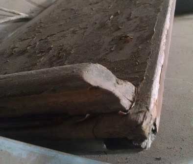

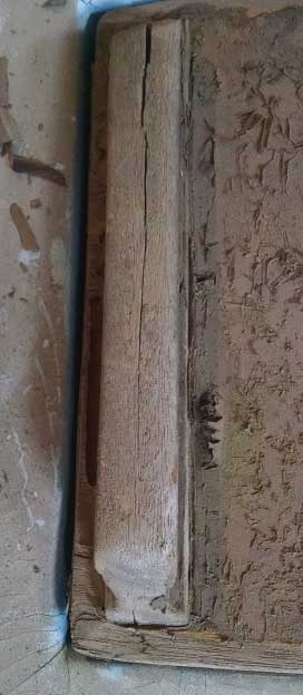

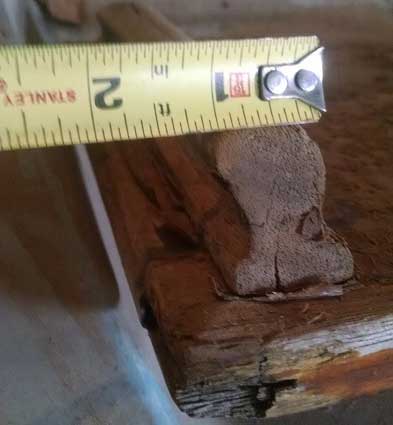

Probably too late to be helpful for you, but our c.1959 has just a board with the two handles or grips. No hinge or any type of fastening as others have mentioned. The handle at its longest point is 9-inch (ends are tapered), at the widest and tallest point they are both 1-inch. My family bought this boat new, so to the best of my knowledge this is the original locker cover.

To me those "handles" look like the pieces on the bottom of the anchor locker cover which keeps it from sliding around when it is closed.

Butch--No. The handles were on top. The cover was recessed into the bow locker and wouldn't slide around. Also, no hole in the cover to lift it up if the handles were down.
