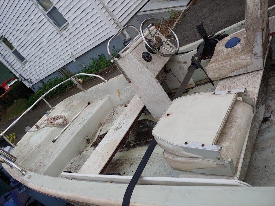

Hi. A friend wants to sell me this boat, and I am trying to find some details about it. The original HIN is not available, it has a state-issued one now.

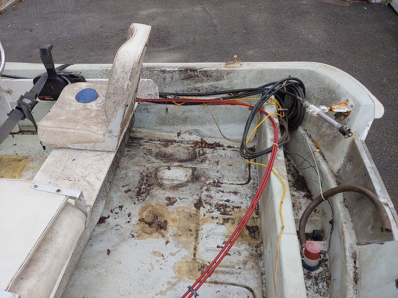

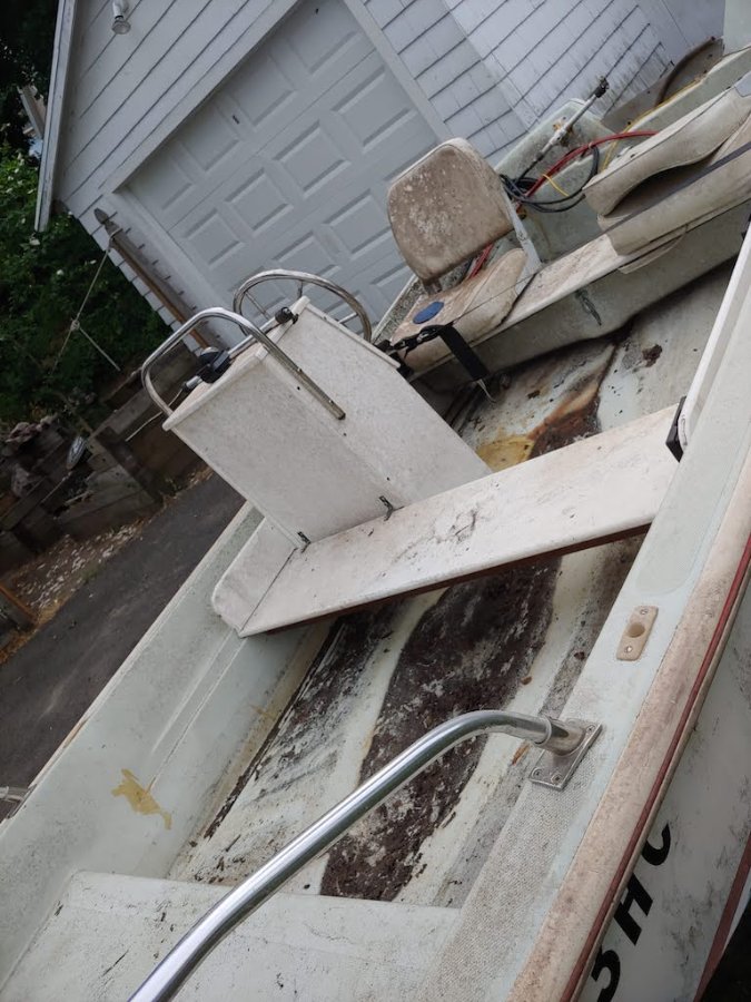

The registration says it is a 1970 13.3 Boston Whaler. That is all the detail it provides. It has a transom cut for a 15-inch-shaft outboard, and looks like it has an aftermarket interior. There is no storage locker in the bow but there is under the pilot transom seat.
I attached some photos. The boat isn't pretty by any means, but with a little elbow grease I feel like I could breath new life into it.
Any help would be most appreciated.

A 1970 boat would never have had a federal hull identification number; they were not in use then.
The forward cockpit at the bow looks very odd.
Unless a stencil number is found there is no proof it was a Boston Whaler. The stencil number might be under that plate on the inboard face of the transom, or painted over.
Whether Boston Whaler or not, the boat is in rough shape.
I defer to Nick for a more authoritative opinion.

That looks like a Dell Quay Dory 13. One of several attempts to copy the Boston Whaler Classic 13.
Re: 1970 Sport 13 Verification
With that bow it looks like a Del Quay Dory.

The Dell Quay isn't bad, the hull shape is almost identical to the original 13. As you can see the bow does not have the small locker. Originally they had storage under the stern seat similar to the later Whaler Super Sports. The are a little heavier than a Whaler, and unfortunately, I have never seen one where the original transom wasn't badly rotted.
