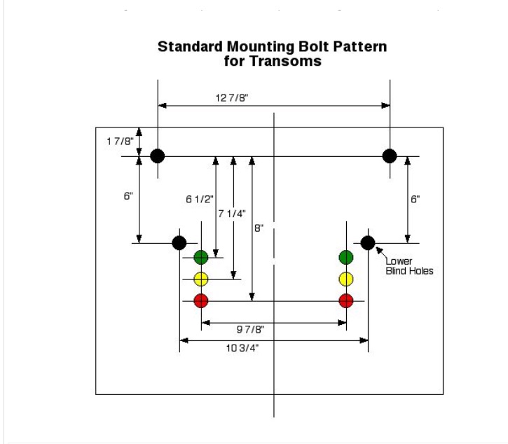

While I am not totally clear on the location of the lower holes, here is a measured diagram for the BIA bolt hole pattern.
For the E-TEC on a classic Montauk, you will want to be "2 holes up", top bolt in 3rd hole counting down from the top at a minimum. At this height, the lower bolts will be ~ 1/2 way up the slot.
Take a look at the diagram, measure your transom and report where the existing holes are located.

Thanks for the info. When we first had the motor by the transom, I put a straight edge on the keel and lined it up with the cavitation plate. That would put it at 0 holes up, just like the old motor. If I put it at 2 holes up, then I should still be able to hit inside the splashwell.

The diagram that Phil has shown is informative, but I don't think it is quite self-explanatory. Because of that, I have created a slightly different and I hope improved version, and began a separate topic thread to explain engine mounting hole locations in the transom in more detail. Please see
