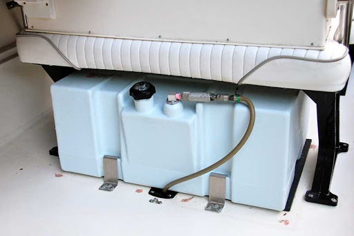

Here are two views of the Moeller white on-deck fuel tank designed specifically to fit under the reversible pilot seat (RPS) that show the tank in place under the reversible pilot seat (RPS):
Fig. 1. Aft view of Moeller white tank under RPS showing fuel hose attachment. The blueish hue of the tank may be due to unusual lighting when the photograph was taken.
    Note: in the above illustration I am not sure exactly what added fittings are being used at the point of attachment to the tank; perhaps an in-line check valve was used. Use of an in-line check valve may be descretionary. Also the fuel hose appears to be an older-style gray hose. Use of modern fuel hose of proper inside-diameter and rugged rubber outer coating is preferred. Follow the recommendations of the engine manufacturer for rigging of the fuel hose. The fuel primer bulb should be located near to the engine and installed so the flow arrow points skyward.

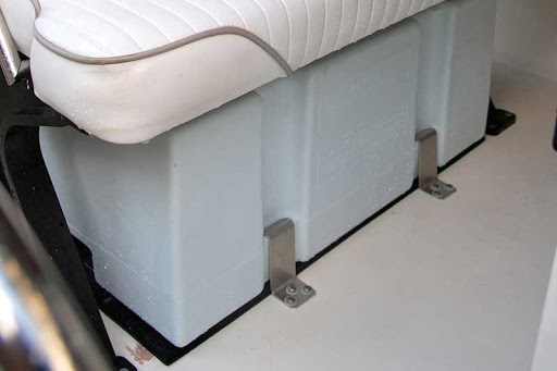

Fig. 2. Forward view of Moeller white fuel tank under RPS. The mounting uses the Permanent Fuel Tank Hold Down Kit.
Photo credit: Jeff Rolfing. I rescued these images from a GOOGLE cache of Jeff's original post that linked to his Photobucket site which unfortunately is no longer available.

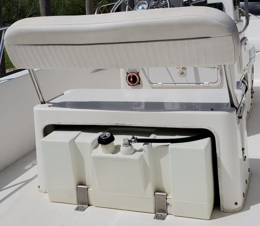

Here is the [Moeller 24-gallon on-deck fuel] tank mounted under the reversible pilot seat (RPS) on a 2005 170 Montauk. It was installed in 2010 and has performed well for over 10 years.
Fig. 3. Moeller tank under RPS on 170 MONTAUK.
