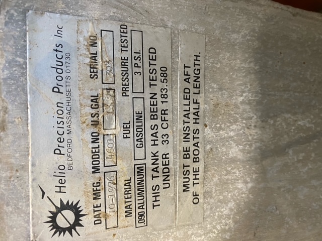

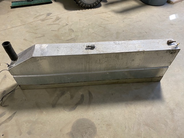

The saddle tanks in the Outrage appear to be original. They are dated 10/76 which seems plausible for a 1978 model year.
One tank was patched with a layer of fiberglass along the bottom 2 inches. I found out why when I filled both tanks with a mixture of muriatic acid and water and left to soak overnight. The unpatched tank puked its guts out sometime during the night and I unwittingly acid etched my concrete floor. So I've decided no matter how good they look, using 42 year old aluminum tanks is a bad idea. I may get a quote from one of the recommended fabricators or make new tanks myself. I just know the original tanks are No Bueno.

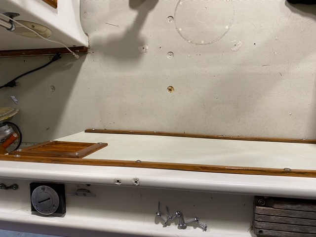

The original tanks were each clamped to a piece of 3/4" plywood which is lag bolted to the floor. Fill is thru the top deck like a ribside and there is no provision for a fuel level sender. This is all hidden behind an "elephant skin" fiberglass panel. My boat has wooden vents attached to the elephant skins near the fill tube which I don't think are correct. My guess is someone cut speaker holes and someone else removed speakers and covered with wood. But that's just a guess.
Also because of the cutouts in the plywood base it looks like the tanks were originally intended to fit snuggly and uniformly against the side hull. But the front end of the tank sticks out over an inch more than it needs to. With the elephant skin attached directly to this plywood base the result looks a bit awkward. Plus I'm losing foot space. My pictures don't do it justice. When I was removing the tanks I figured out why it was this way. Both tanks are identical and the fill tube is centered. So each tank has to be installed crooked so the fill tube is in the right spot. Bean counters 1, designers nothing.

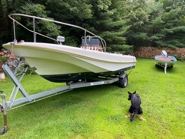

What is the purpose of the pink line tied at the bow as seen in Figure 1?

Your guess is as good as mine as to what the pink line was about. I think the winch is too high on the trailer and is putting undo stress on the bow eye. Perhaps it was to keep bow from bouncing due to poor winch placement? In any case I am going to adjust winch.

KLADD—I think the bow stem eye should land between the two small rollers of the bow stop or bow rest rollers. Use an adjustable ratchet strap connecting between the bow stem eye and the trailer frame to exert a downward pull on the bow to suppress any tendency for the bow to bounce up. The winch strap should lead between the two small rollers and exert a slight upward pull. That helps pull the boat onto the trailer. A winch strap that pulls the boat downward onto the trailer just makes loading the boat unnecessarily harder and requires more tension be exerted onto the bow eye.

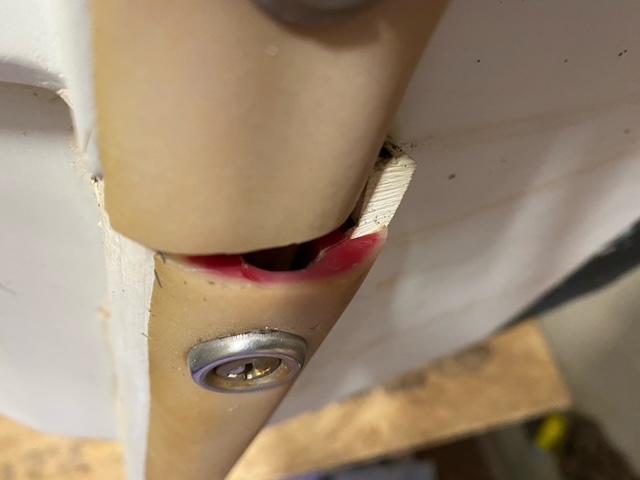

Its confirmed. Yes the rub rail was red. And yes a new red one will look fantastic. Of course now I will also have to freshen the whaler decals etc etc!
Better call Janis....
- evidence of red rub rail
- image0 (5).jpeg (56.72 KiB) Viewed 7147 times
Re: 1978 Outrage19 with Mercruiser 470
You may want to wipe down the rubrail insert with Acetone to see if it will come back.
