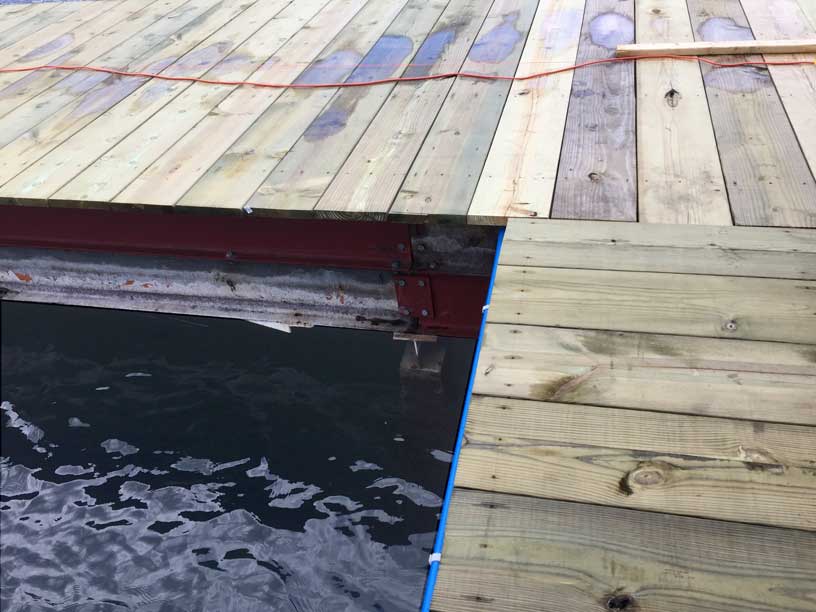

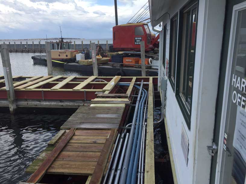

The Village of Northport has undertaken a substantial renovation of the main dock ("C" dock) and its fuel dock. The deck level has been raised about 16-inches. New steel I-beams have been laid atop the original steel supports, and a new wood deck surface has been laid atop the steel risers. All new electrical conduits have been installed, now well above the waterline at the main dock. New individual pedestals for power and water will be installed at each slip on the main dock and will provide 50-Ampere, 30-Ampere, or 20-Ampere 120-VAC power, as appropriate to the slip size. New PEX water lines have been installed to each adjoining slip. And new gasoline and diesel fuel pipes have been run to the fuel dock dispensing pumps from the fuel storage tanks on shore.
Fig. 2. The main dock at Northport, Michigan, showing the dockmaster building and the fuel dock. Much new electrical conduit and new circuits are in the process of being installed. The gray and blue conduits may be associated with the fuel pumps.
Fig. 3. The new decking laid atop the new steel on the main dock at Northport, Michigan. The water level from the prior year (2020) can been seen on the old steel I-beams from the white watermarks.

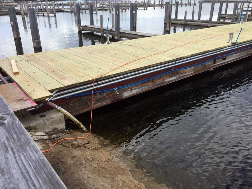

Fig. 4. The land end of the main dock at Northport, Michigan, showing new water lines and new electrical conduits.
This work is being done under the "Northport Marina Dock Phase 1 Repair Project." The work included in this phase is:
  • Raising of dock with structural steel including all bracing, bolting, and welding
  • Removal and replacement of wood decking
  • Temporary relocation of existing harbor master house
  • New electrical service, distribution, and marina service outlets
  • New domestic water plumbing
The total project cost is "just under" $600,000. The Village has funded 51-percent of the cost, and the other 49-percent has been funded by a grant from the Michigan Waterways Commission. This phase of the project is scheduled for completion in April 2021.

I find it highly surprising the new docks are fixed rather than floating.
Given the variable level of the lake, it would, to me, be prudent to take this into account in the design. A future period of higher water levels will result in repeating the same damage as before.
Steel piles and concrete floats are very durable and long lasting. Even longer since it is fresh water.
Wood decking--wow.

Phil T wrote:Wood decking--wow.
What other material would you suggest for the deck level of the piers?

As for decking, if boards are required, composite materials. Other materials include stamped metal planks or panels or concrete.

Phil T wrote:As for decking, if boards are required, composite materials. Other materials include stamped metal planks or panels or concrete.
I certainly would not want to strike the hullside or gunwale of my classic fiberglass boat into concrete or metal deck surfaces. Wood is more forgiving. I cannot reacall any marina docks in the Great Lakes using anything but wood for the deck layer on their docks and finger piers. Maybe here in the Great Lakes we are in a backwater of modern docking. But where else can you cruise in beautiful water and have a public marina spaced about 20 to 30 miles apart all along several thousand miles of coastline waiting for you with an inexpensive transient slip for overnight docking?

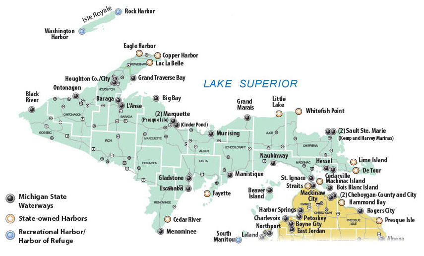

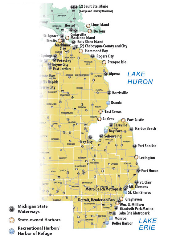

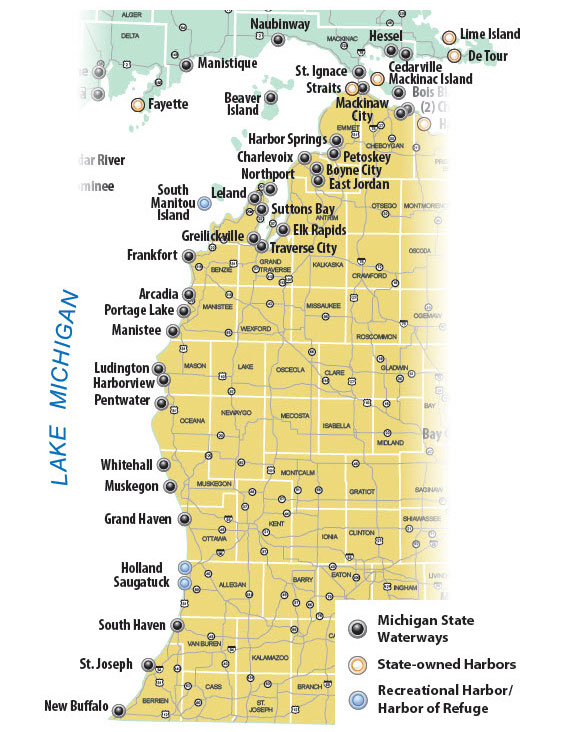

Here are three maps showing the State of Michigan harbors.
Fig. 1. Upper Peninsula Harbors
Fig. 2. East Coast Harbors
Fig. 3. West Coast Harbors
I don't think there is any other state with facilities like these.

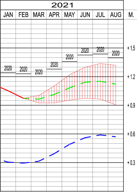

Getting back to the actual topic, Lake Michigan water levels for 2021, the U.S. Army Corps of Engineers (USACE) publishes their best guess every month. Their latest best guess is found at
https://lre-wm.usace.army.mil/ForecastD ... ch_hrn.pdf
Here is an excerpt from their graph that is current when I am writing:
Fig. 5. LAKES MICHIGAN-HURON WATER LEVELS--MARCH 2021. The red line is actual data; the blue line is long-term average of actual data. The green line is "most likely" outcome. The shaded red area is range of possible outcomes. Vertical scale is METERS above CHART DATUM.
Since 2020 was the record-setting year for high-water for the past maybe 100-years, there is no surprise that 2021 is not estimated to exceed those levels. The extraordinary high water in 2020 was probably due in some part to the extraordinarily cold winter of 2018-2019 over the Great Lakes which saw very high percentages of ice cover; ice cover reduces evaporation and creates higher water levels.
Reading the graph is a bit awkward for boaters thinking in terms of feet or inches. Each vertical division is 0.05-Meters or 1.97-inches--call it 2-inches. Looking at the level in February 2021 we see it is about five divisions or about 10-inches below 2020 level. The predicted range for Lake Michigan into July 2021 shows the water will be somewhere between 4-inches to 16-inches below July 2020, and the "most likely" level will be one-foot below last year.

As the USACE chart above shows, a typical variation in water level over six months might be ten inches for Lake Michigan. On an odd weather and winds situation a seiche might cause that much change in a hour, but they are rare and localized.
