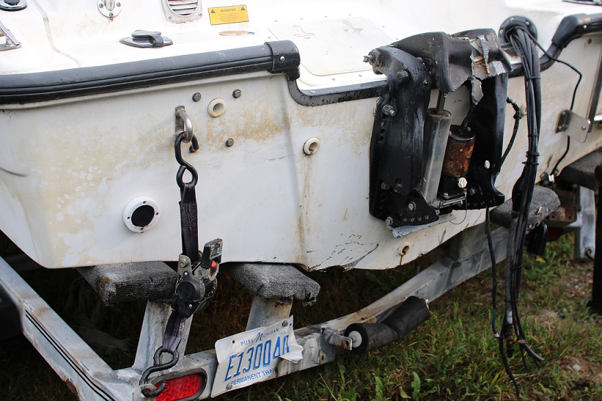

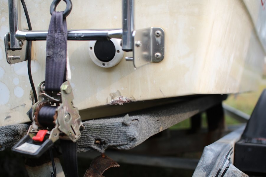

Just a short follow up and some answers:
- yes, I did/do love the boat, very practical for my needs;
- I ended up buying it back; and yes, the engine is part or the buy-back;
- a few more pictures of the damage attached...

Re: 2003 Dauntless 160: Save or Scrap
Postby Phil T » Tue Sep 14, 2021 10:00 am
Any bow damage?

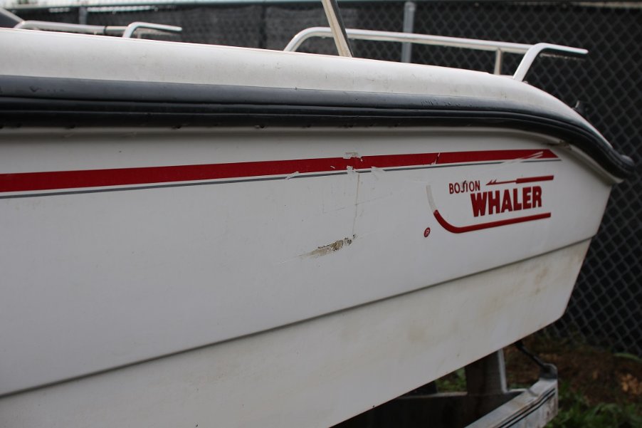

Postby duke0372 » Tue Sep 14, 2021 10:36 am
Very little; I have some side damage from over a year ago that I'll try fixing at this point as well, but that was me (scraping it along a steel seawall).

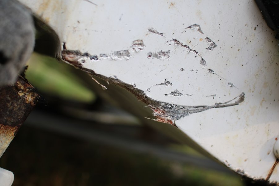

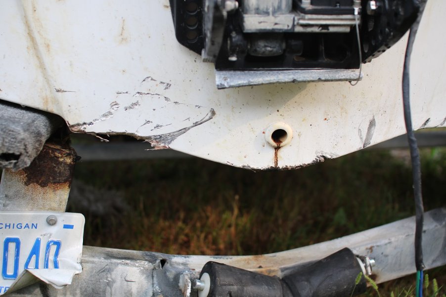

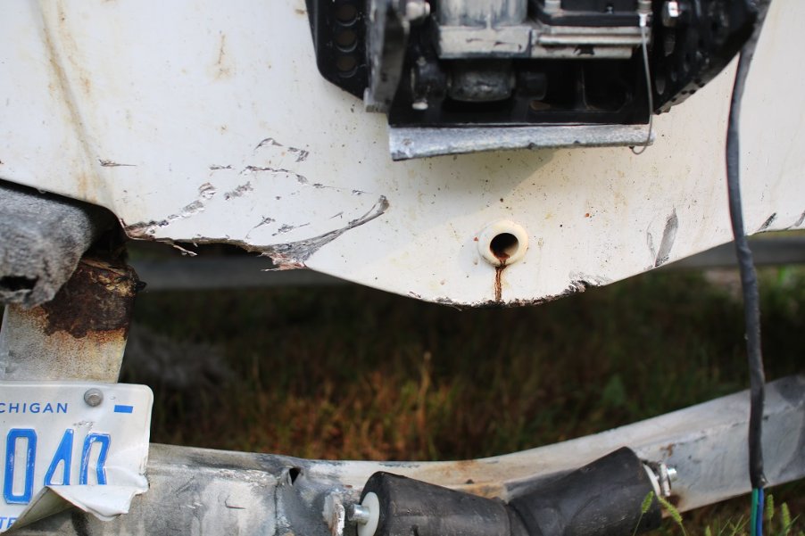

I don't see anything too serious. The only thing that catches my eye is the first close-up photo of the transom, it looks like the fiberglass skin might be peeling off the portside strake. That might turn into a somewhat larger area of repair than it first appears, but nothing here looks structural.

Correct, the biggest damage is where you pointed it out and one more spot, not as bad as the first one though - two close-up photo's attached

Postby GoldenDaze » Thu Sep 16, 2021 8:51 am
You've got some work to do but really it doesn't look all that bad. And you get a new engine out of it, so that eases the pain a bit. If you haven't seen Tom W. Clark's article on hull repair, check it out at https://continuouswave.com/whaler/reference/whalerRepair.html. Good luck!
