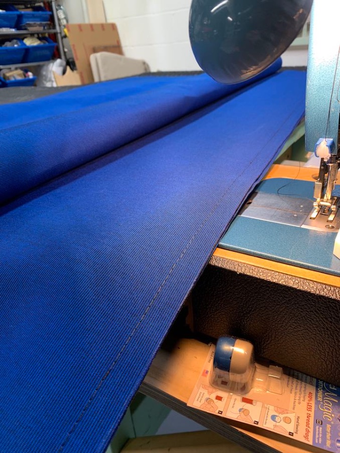

Readers may enjoy seeing my first boat cover project for my 9 Tender.
I used [Pacific Blue] Sunbrella cloth. I assembled the cover with my Sailrite LSZ-1 sewing machine.
My success on this project may inspire others to take on similar work
I still need to figure out how I want to hem around the motor well area (and if I want to integrate a motor cover), and to install the permanent snaps.
Fig. 1. Cutting the first of three panels, laying across the beam of the boat.
Fig. 2. Using seamstick to attach two panels, prior to sewing.
Fig. 3. The first stitch.

Fig. 4. Semi felled seam.

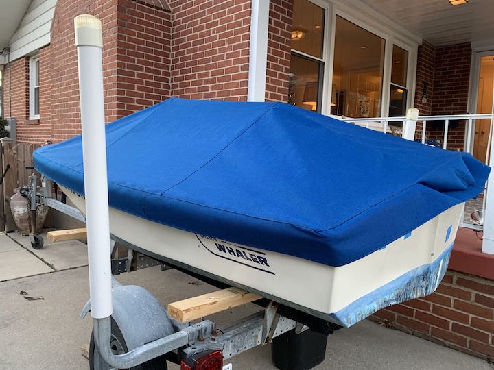

First dry-fit and marking of the rubrail for trimming:
Fig. 6: First dry-fit and marking of the rub rail for trimming

Fig. 7. Another view of dry-fit.
FIg. 8. Cutting strips to make a perimeter skirt.
Fig. 9. Dry-fit with perimeter skirt installed.

Fig 10. Detail view of stitching.
Fig. 11. Installed with temporary snaps (snaps were already on the hull from prior owner but no cover).
Fig. 12. Another view.
The weather has been too cold to finalize the project, I'll post more when it is complete.
