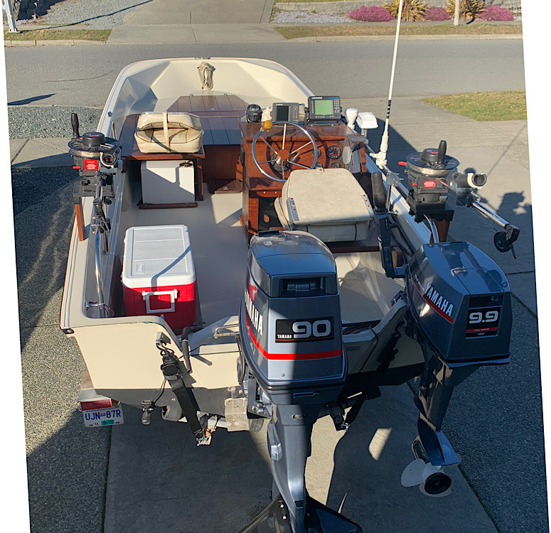

Fig. 1. Stern view of the 17-footer set up for guided angling.

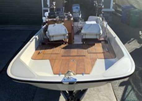

Fig. 2. View from the bow of the 17-footer set up for guided angling.

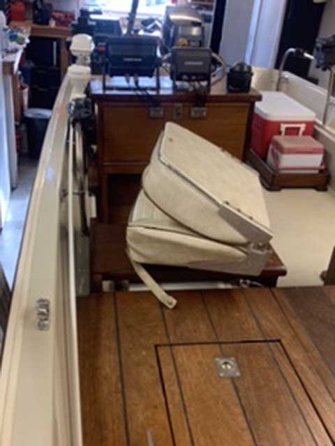

Fig. 3. Cockpit details.
Since the photographs were taken I have I waxed the hull and topsides and used teak oil on all the wood.

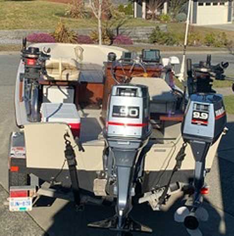

Hopefully this photo is better.
Stern view
