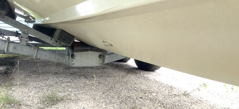

There is only one set of keel rollers and they are mounted on the forward main crossmember of the trailer frame. (A crossmember is a transverse structural support that crosses between the two main longitudinal supports of the trailer.) The bunks are mounted so they begin at the boat transom and extend forward along the hull until the V-hull shape begins to change from a nearly constant moderate deadrise to a much deeper V shape.

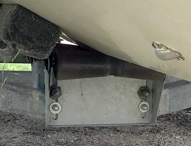

The keel rollers are installed in pairs, two rollers on one crossmember. The brackets sandwich the crossmember and are held in place with straight bolts, not U-bolts. To raise the height of the rollers above the crossmember, I have drilled two holes through the crossmember (on its exact vertical centerline so as to minimize any loss of strength). The lower mounting bolts pass through the brackets and through the crossmember. The upper mounting bolts pass through the slots on the bracket and just lay atop the crossmember.
Fig. 1. The crossmember of the trailer frame has been drilled to permit the roller bracket to be mounted higher. An identical bracket and roller are on the aft side of the crossmember, but not easily seen in this view.
Fig. 2. The rear roller of a pair. The upper mounting bolts just lay atop the crossmember.

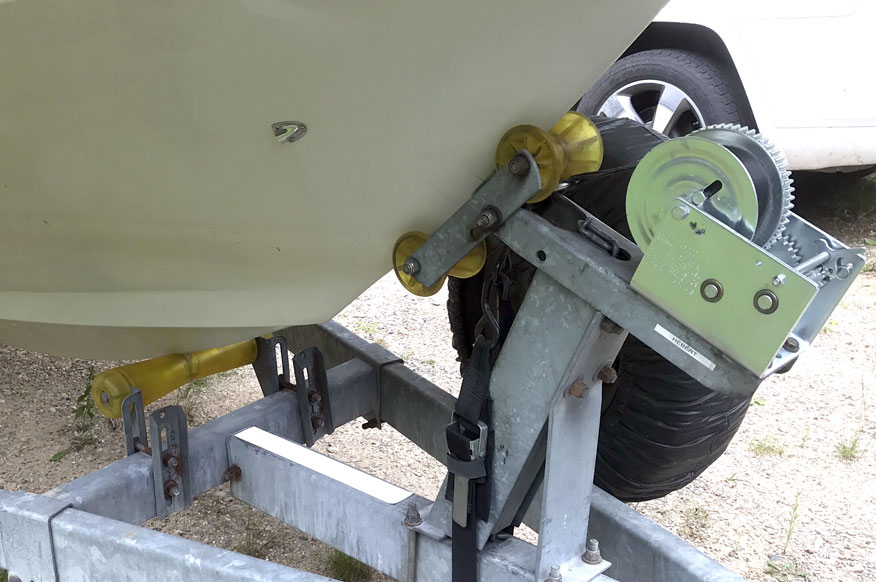

My trailer's bunk arrangement is somewhat unique. There are four bunk supports in total. These are arranged in two sets, port and starboard. The bunks are attached in pairs to a frame. The frame pivots to fit the bunks to the hull shape. The distance between the bunks on the pivoting frame is adjustable.
Fig. 3. The bunks are position so the outer bunk is well clear of the hull runner. The inner bunk is as close to keel center line as practical. Note the longitudinal tube that supports the bunks and allows them to pivot to meet the hull shape. This is an unusual feature.
The outer bunks are arranged to fit inside the hull runners, and particularly to clear the venturi cover on the through-hull drain on the starboard side. This prevents the drain cover from being crushed if the were loaded onto the trailer with the bunk right under the drain.

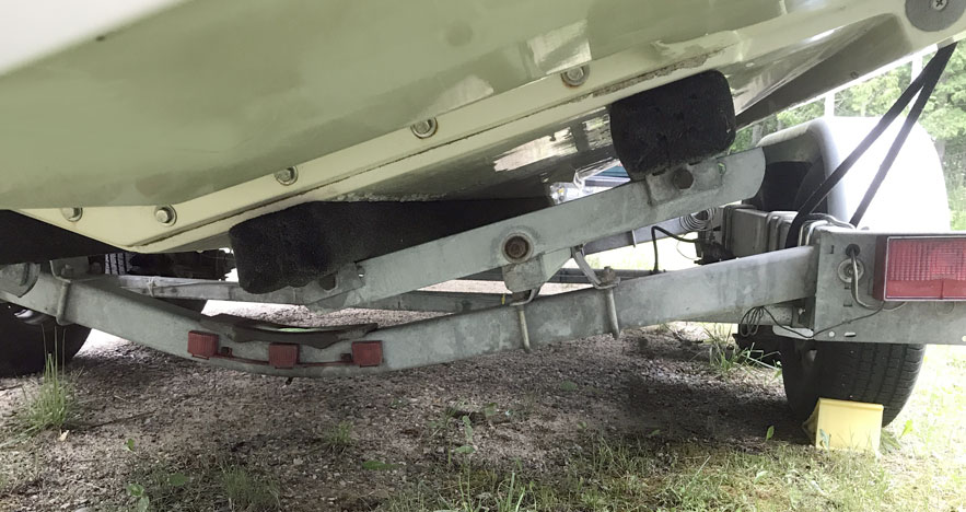

The overall height of the boat on the trailer is controlled by one factor: the clearance between the hull chine and the top of the fender. This is generally the controlling influence for any boat on any trailer if the beam of the boat is wider than the distance between the trailer fenders.
Fig. 5. The hull chine clears the trailer fender top by about 1.5 to 2-inches, depending on how evenly the boat comes onto the trailer.
On my boat-trailer rigging, the separation between the top of the trailer fender and the boat hull chine is about 1.5 to 2-inch. I have seen some rigs with even less clearance, about an inch.
