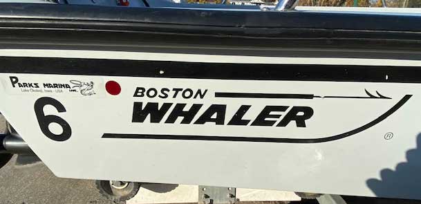

Fig. 2. A red dot on the hull of boat to be identified

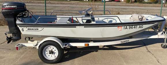

Fig. 3. A boat to be identified.
Is my boat Sport GLS2?

The boat shown in the photo is a 13 Utility produced by the Commercial Products Division (CPD) of Boston Whaler for a commercial customer. It is a heavy duty version of the 13 Sport.

A hull from Commercial Products Division (CPD) of Boston Whaler is not automatically a red dot. The extra lay up of resin and cloth was a stand alone option that could be ordered or not. The Red Dot or Black Dot placed in the gelcoat acknowledged that installed option.

As mentioned, the RED DOT marking indicates heavier hull lay-up was done. This is called a "work boat" hull. So the boat would be a 13 STANDARD with Work Boat hull lay-up.

From the photograph I believe your boat is sitting on a roller trailer. Roller trailers are not usually recommended for Boston Whaler hulls due to the possibility of dimpling of the hull. In the case of a fairly light CPD hull this may be unimportant but it could be worth your time to look into that.
