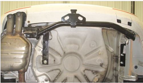

I also think it would be rare to have this car with a factory installed hitch and highly probable that the hitch on your car is an after market installation. As you can see in the picture there is not much to bolt the hitch on to. The primary use for a hitch on this type of vehicle is typically for items such as a bike rack.
