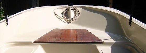

A bow locker hatch made of wood is the most appropriate for a classic 13-footer. A hatch could be made from wood material such as tongue-and-groove flooring planks. Coating the wood with epoxy will make it completely waterproof. Coating the epoxy with varnish will give it UV protection. Wood with epoxy and varnish finish becomes very durable, almost like a piece of plastic instead of wood.
The replacement hatch on my SPORT 15 was made from three boards. On the underside there were two narrow boards running at a right angle to the fore-and-aft boards of the hatch, and these underside boards held the whole assembly together with countersunk screws. Those two boards were at the front and back edges and helped position the hatch in the deck opening.
Fig. 1. A replacement bow locker hatch cover made from three boards.
