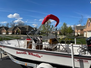

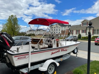

In Spring 2022 I bought the Carver Bimini in stainless steel and Sunbrella, and I am very pleased with it. I installed the frame hinge on the gunwales. Although I did purchase a track, I have not installed the track.
Fig. 1. The Carver Bimini top fully deployed.
Fig. 2. The and bows folded into the frame.
Sliding the frame aft on my Montauk 17 interfered with the engine when the engine was trimmed up for trailering and storage. Sliding the frame forward would have allowed the top to go over the bow railing. but I felt that position would create a problem for the boat cover.
I decided to install the Carver Bimini top without the tracks after dry fitting the cover and trying various down positions. I still have a new 24-inch-long track. I may eventually install the track to allow for more position options when the Bimini top is deployed
The clearance under the Carver Bimini top is plenty high enough for a six-foot-two person.
The antenna for the VHF radio is mounted at the console; the antenna fits under Bimini top when the top is deployed.

In Figures 1 and 2 the aft frame support tubes are set at quite an angle.
What was your thinking on the choice of angle for the aft frame support tubes?
I would have expected those frame tubes to mounted almost vertically.

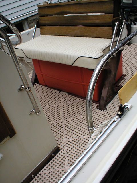

Fig. 99. The slides from my 1987 Montauk 17.
deck RPS.jpeg (57.39 KiB) Viewed 7834 times
Q6: Is this the same location you are planning for?
