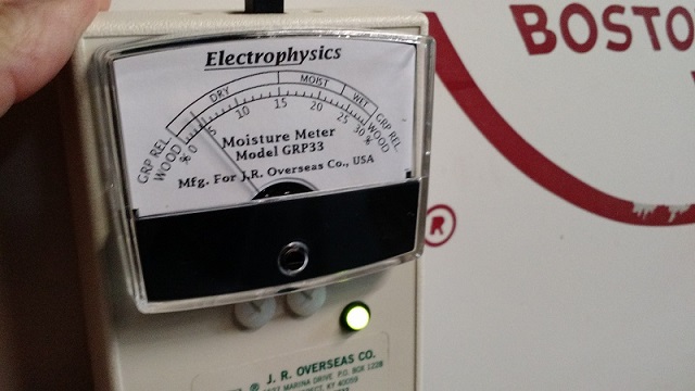

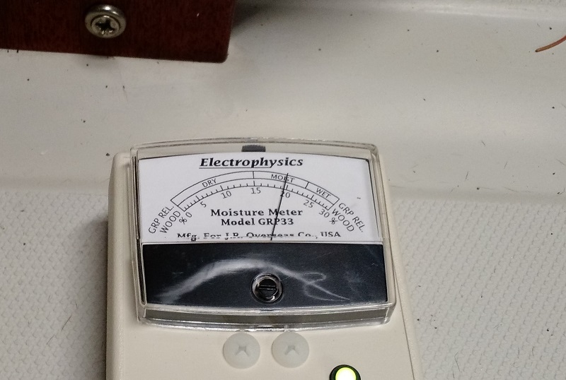

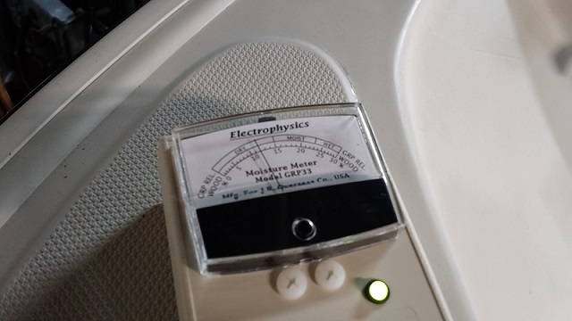

As an additional data point, I took some readings from a 1980 Boston Whaler 13' Sport using a JR Overseas Model GRP33 Moisture Meter.. The readings on the deck and hull were between dry and moist as indicated by the GRP relative scale on the meter.. See pictures below. An important factor to consider when using a moisture meter is the amount of moisture on the surface to be tested. If the surface is not completely dry the readings will be off. I typically clean the surface with alcohol prior to testing. If there is metal near the point that the reading is taken, then the readings may differ as well. This includes the copper in bottom paint. I have found that all of my deck surface reading on the 13 Sport were slightly higher that other areas. I cannot conclude whether this is due to higher moisture content or if the meter is receiving a reflective reading from the copper in the bottom paint of the bottom (other side) of the hull.
I also performed the same test on a 2000 Boston Whaler Conquest 28 and had very similar results. Of course this does not mean that there are any concerns about the hulls that you tested. These are just two additional data points taken with a different meter on different hulls.
