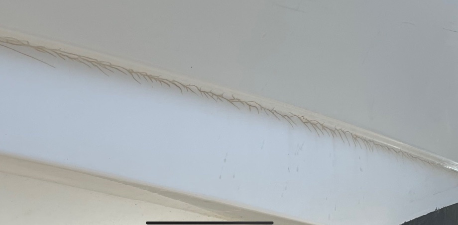

Thanks for the info gents, I was out of the country and having trouble figuring out the pic function. Here’s a pic of the cracking. The seller said he never noticed it prior, which I admit I find a bit tough to believe.
Fig. 1. Cracking in hull bottom along strake.
Re: Assessing Hull with Unusual Cracking
Postby jimh » Thu Jul 27, 2023 8:30 pm
The most curious element in Figure 1 is the abrupt change in the hue of the gel coat between the strake and the hull.

jimh wrote:Q5: is there any chance the Strake was not original to the boat?
I don’t think so, at least the other side seemed more uniform. The side of the boat with the cracking was parked against a fence,. [Perhaps] that is causing the color difference from a shadow or reflection in the [illustration seen in Figure 1].
The pattern of the crack makes me think it’s not from a central impact, that it is a result of a crack that has spread slowly from the front to the aft section of the hull along a weak bit of gelcoat. [The appearance makes] me think it may be superficial and not indicative of trouble underneath, but that’s why I’m checking with those more experienced than me.

Postby Phil T » Fri Jul 28, 2023 1:24 pm
Remember these boats are hand made.
The photo above shows gelcoat spider cracking that is typically found on curving or corner surfaces when it was applied too thickly and has dried out due to exposure.
It is cosmetic.
Detailing the gelcoat and removing the oxidation will lessen the visual sign of the spider cracks. The purists would have the cracks ground out and the gelcoat reapplied costing several thousand dollars when done by a professional.

Postby Pugster » Fri Jul 28, 2023 2:16 pm
Phil T wrote:Remember these boats are hand made.
It is cosmetic.
PHIL T :Thanks . I am having the hull looked over on July 29, 2023. I found a surveyor. He looked at the picture and said something similar.
