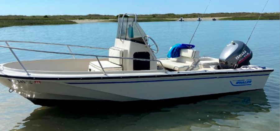

For three years I have owned a 1994 OUTRAGE 17 with a Yamaha F115 engine.
Fig. 1. A 1994 OUTRAGE 17.
[Moderator's note: when taking a photograph of an object that is longer than it is tall, hold your camera in the landscape format. In the photo above the camera was held in the portrait format, and most of the picture was sky and water. Note that the photograph crops off the bow of the boat. When showing a boat in profile, the entire boat should be included.]
