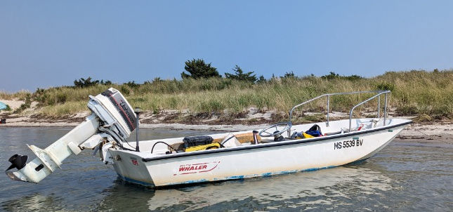

Thank you for your research. I really appreciate it. The [model designation] on the Johnson outboard, J30ELCCE, indicates a 1988 engine. Perhaps the engine is the original.
Figure 1 shows the boat and the engine.
Fig. 1. A 13-footer whose HIN is the topic of this discussion.
--Sam

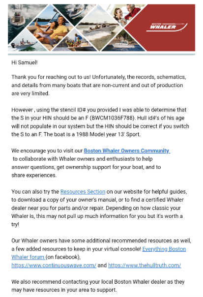

I received a speedy reply from Boston Whaler.
Boston Whaler Customer Service wrote:Hi Samual
Thank you for reaching out to us. Unfortunately, the records, schematics, and details from many boats that are non-current and out of production are very limited.
However, using the stencil ID number you provided, I was able to determine the the S in your HIN should be an F (BWCM1036F788). Hull ID numbers of this age will not populate in our system, but the HIN should correct if you switch the S to an F. The boat is a 1988 model year 13 SPORT.
They also suggested continuuousWave.com as a resource.
Fig. 2. A screen capture of an email from Boston Whaler as viewed the email recipient's email mail reading application on a mobile device.

Changing the HIN to BWCM1036F788 indicates the production month was June 1987. The Boston Whaler factory must have switched to building the 1988 model-year boats earlier that usual that year.
The confusion between the letters F and S must have occurred when someone copied the HIN verbally as read to them by someone else. It would be very odd that someone would visually mistake a written letter F as the letter S.
To hear that Boston Whaler customer service was able to help in this situation is very encouraging.
