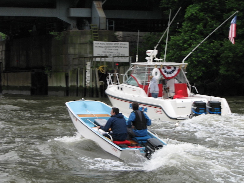

I circumnavigated Manhattan on two occasions with my classic 13-foot Sport. I ran out of gas the first time, so I brought a spare can of gas the second time. This was with a 35-HP classic two-stroke engine and 6-gallon gas tank.
You will be fighting the current for a portion of your trip; I found the Harlem River to be especially grueling: I spent a lot of time at 3/4 throttle but making poor headway.
Fighting the current in the Harlem River.
