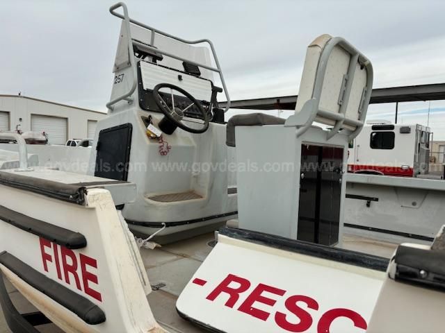

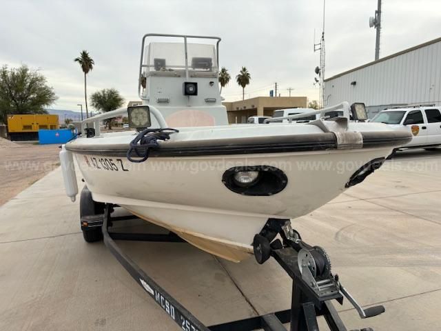

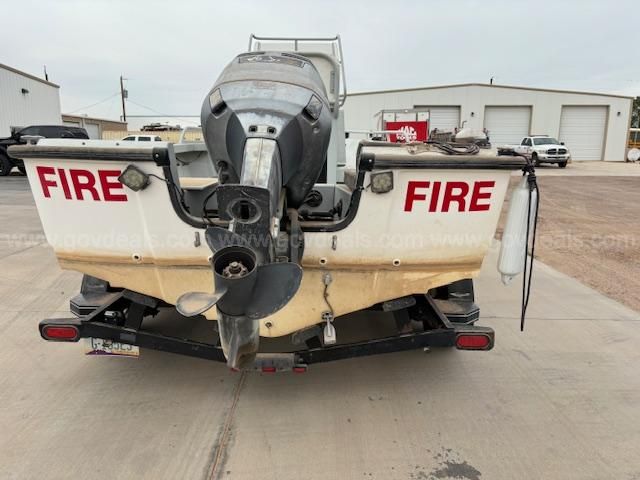

Please help me identify a boat at auction that claims to be a Boston Whaler, but has the following HIN:
BSCYA431K697
A search of this HIN says [this three letter code BSC indicates the boat] was manufactured by BOATSMITH.
The hull [seen below in Figures 1, 2, and 3] looks like [a Boston Whaler boat] , but other features on the deck look different.
Fig. 1. A boat whose manufacturer is to be identified from this photograph.
Fig. 2. A boat whose manufacturer is to be identified from this photograph.
d
Fig. 3. A boat whose manufacturer is to be identified from this photograph.
Q1: what is your opinion of the manufacturer and model of the boat seen below?
Re: Identify SENTRY from HIN and Photographs
Postby jimh » Sun Dec 10, 2023 1:57 pm
From the three photographs the boat certainly looks like it was made by Boston Whaler and could be a SENTRY model.
Q2: do you have a photograph that is clear and high resolution that shows the actual HIN on the boat transom?
I suspect that somewhere in the process of this boat's ownership and transfer to an auction website, the HIN number that you give is not correct.
The Manufacturer Identity Code (MIC) for Boston Whaler is BWC. In the period c.1997, when Boston Whaler made a commercial or government hull, they still used the MIC code BWC. On or about July 20, 2001, a commercial or government hull made by Boston Whaler would typically have been provided with a HIN in which the MIC was WCG for Whaler Commercial Group. If the claim that the boat at auction is a 1997 model, then it would have typically had a MIC as BWC. The avowal that the boat's HIN begins BSC is very unusual.
pcloward wrote:The hull [seen below in Figures 1, 2, and 3] looks like [a Boston Whaler boat] , but other features on the deck look different.
I do not agree with this judgement. The boat looks very much like a product of Boston Whaler. Other than this deviation in the HIN, the rest of the boat just screams Boston Whaler Commercial or Government Products division as the manufacturer.
Postby jimh » Sun Dec 10, 2023 2:23 pm
pcloward wrote:If I can find a higher resolution and larger image and zoom in [to show the HIN], I will update this thread.
The HIN should be visible in Figure 2, but I doubt there is sufficient resolution in that image to show anything useful. Actually, the HIN is really not seen at all in that image, which is strange.
Postby jimh » Sun Dec 10, 2023 2:27 pm
Also, the hull was NOT properly prepared for continual immersion in the water. The hull should have been given a barrier coat and perhaps an anti-fouling coat to protect the gel coat resin from intrusion of water and attachment of marine growth.
The hull stains from the water may be able to be removed using a hull cleaner. A popular hull cleaner is MARYKATE ON & OFF HULL & BOTTOM CLEANER.
If you use the above cleaner while the boat is on a trailer, be certain to wet down the trailer with plenty of water and to immediately rinse off any of the cleaner that drips onto the trailer. The cleaner will tend to harm galvanizing and aluminum.
