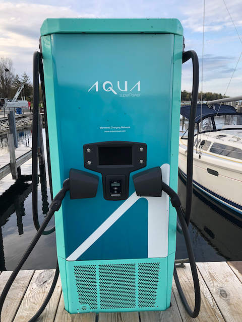

There must be some grant money going into electrification of boats, or at least that is my deduction from seeing the installation of a very large, very powerful boat charging facility at the local marina in tiny Northport, Michigan. I asked the harbor master who was paying for the installation, and he indicated it was NOT paid for by the village that owns and runs the marina, but by some sort of outside funding source--I forget exactly what agency or company. That charging station was installed in Spring 2023. As far as I know, it is still awaiting its first boat and first paying customer.
The charging station was installed as part of a significant upgrade of the marina electrical system on the main dock (which includes the fuel dock), which was done essentially to get the electrical conduits above the recent (2022) high water mark that had put some of them under water. The refurbishment of the dock was part of a very large expenditure on marina improvements, including an attempt to stop the parking lot from being flooded by Lake Michigan at high water levels.
Fig. 1. A charging station for boats with electric propulsion motors, located in Northport, Michigan, and installed in May 2023.
Although hard to read in the illustration above, the charging station include a URL:
http://aqua-superpower.com
According to their website, there is another charging station installed across Grand Traverse Bay, about 20-miles away at Elk Rapids. I suspect that may be because the range of the typical present-day electric boat is probably not more than 20-miles. For more charging locations see
https://www.aqua-superpower.com/explore-network/
ASIDE: Bob--it is almost 4 p.m., so my regular afternoon IPA beer will be dedicated to you and your interesting comments on "the future of boating." Don't worry about having written a reply too long. I do not eschew prolixity.
