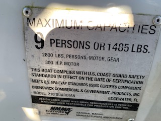

My 2018 GUARDIAN 210 (length 21-feet 4-inches) was built-to-order and purchased through Brunswick Commercial and Government Products Division, as will all GUARDIAN models now be This GUARDIAN 210 has a placard indicating maximum power, maximum weight, and maximum number of persons.
Fig. 1. The federally required capacity plate on a GUARDIAN 210 boat, indicating 300-HP motor permitted.

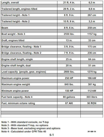

Interestingly, the manual provided with the boat states:
    ”The United States Coast Guard requires boats less than 20 feet (6 m) to display a capacity plate that indicates the maximum number of people and the maximum weight that the boat can support under normal operating conditions.”
This may be suggesting some larger boats may not have placards, but mine did.
The 2013 manual indicates the maximum engine power is 250 HP (See Figure 2 below.)
Fig. 2. Page 6-1 from the manual listing specifications for a 2018 GUARDIAN 210.

PETER—thank you for the clear verification that a GUARDIAN may have a federally required capacity plate. Perhaps that you were an individual buyer and not a military or government agency affected the inclusion of the capacity plate.
Because your boat is larger then 20-feet, the inclusion of the capacity plate would not seem to be required, but as seen in almost all Boston Whaler boats, there usually is such a plate, no matter the length of the boat.
Also a bit odd is the variation in rated power: the plate says 300-HP; the manual says 250-HP.
