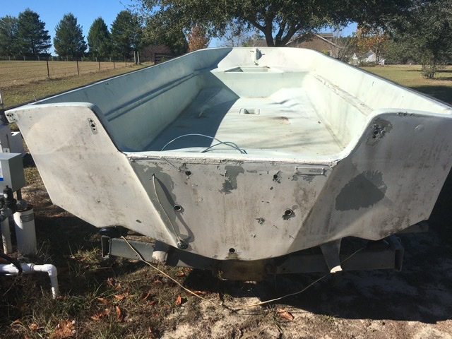

Give a view of the hull at the transom as seen from astern.

Postby K9medic » Sun Dec 15, 2019 11:23 am
Fig. 1. Rear view of hull.

It is important to note the Guardian 17 is a recreational Montauk 17 hull with added reinforcement in strategic areas and a customizable interior offered by the Commercial Products Division (CPD) of Boston Whaler since 1983. In 2001 the division was moved to its own facility and renamed Brunswick Commercial & Government Product Division (BCGPD). In 2018 the division was shut down and its products were integrated into Boston Whaler.
Your photo shows a bare hull so it has limited value and is nominally more valuable than a bare 17' recreational hull.

Figure 1 show what appears to be a hull molded in gray gel coat which has then been painted in a shade of while, with the paint now peeling off. There appears to be a federal HIN metal tag riveted to the hull on the starboard side of the transom notch. Take a close-up image of the HIN and more information may be available with the number. The lifting or towing eyes are missing. There is a ground electrode and conductor on the port side of the transom.

No further photographs will be necessary for the purpose of making an appraisal for the value of the hull. The ones posted already show sufficient information to make a rough estimate of value without an actual in-person inspection.
The HIN is probably missing some information. It does not match either of the two known formats. The last two digits "85" may be indicative of 1985, but if they are, then the HIN is not supposed to be on a metal tag. See the FAQ for more comments on decoding the HIN.
Give the HIN tag a closer look and concentrate on finding possible pre-printed characters on the metal tag that supplement the embossed characters.
IMPORTANT: if the boat hull were molded for commercial duty, it would have been a Work Boat hull, and the HIN would contain the letters WB to indicate that modification. Without the WB suffix, the only indicators of the boat being a GUARDIAN hull are the larger rub rail and the gray gel coat.
The location of the rigging tunnel port about 84-inches from the splash well is consistent with the drawing of hull reinforcements from Boston Whaler hat is provided in the REFERENCE article on this boat. See
http://continuouswave.com/whaler/reference/16-17/
and
http://continuouswave.com/whaler/refere ... 0x743.jpeg
In terms of restoration, many essential components are missing from this hull. If your plan was to restore the hull to be a normal MONTAUK 17 with center console, railings, seats, and the usual standard accessories, you will need to obtain dozens of OEM parts. I doubt you can find all the parts easily or at bargain prices, and on that basis a restoration will be very expensive. I recommend you abandon this hull if restoration to original was your aim. A further consideration against a complete restoration is the apparently unknown history of use of the hull. Generally hulls purchased from individuals come with some history of use, which permits the buyer to have insight into what problems might be hidden from view.
If you just want a nice 17-foot hull to be the basis for creating a small boat of your own layout and design, this hull will be suitable, assuming the hull has no soft spots, has not gained significant weight from ingress and retention of water into the interior foam spaces, and has a transom with good strength and integrity.
So far, the only evidence that would affect my original estimate of a value at $1,000 for a quick sale is the trailer. The trailer looks like it might be worth $100, and possibly more if it does not need substantial renovation. The trailer also facilitates the sale of the boat as it allows the buyer to tow it away. Thus I now estimate the value of hull and trailer about $1,100 if interested in a quick sale. As in any offering of an item for sale, the lower the price the more potential buyers. If you want to sell at a higher price it may take longer to find a buyer.
The larger rubber rub rail is a neutral factor. If you like the big rub rail and it is still flexible, then you won't have to spend $250 getting a rub rail replacement kit.
