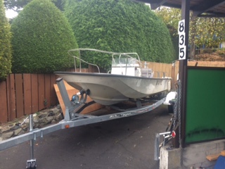

Hello All,
We just purchased a 1989 classic Montauk with almost all its original pieces. Also in the package was a galvanized trailer and BayStar Hydraulic Steering, but no power.
I signed up on this site a few weeks back and have been reading posts and articles about Classic Montauk boats. As many probably have experienced, this isn't the best thing for a relationship. She will get over it, currently she is used to bouncing around in my 16-foot Zodiac rigid hull, no space or comforts compared to the Montauk. (Or so I have sold her on it )
So, after all the reading I made the first big move. I just had a friend at the Coast Guard station weigh it with their crane and calibrated hook scale. I was pleasantly surprised, it came in at 1,128-lbs. I called Boston Whaler and spoke with a very nice fellow named Tom. He listed what is included in the 900 lbs. He also informed me that some hulls could weigh up to 40-lbs more due layup discrepancies. The 900-lbs includes: stainless railings, center console, seat, no fuel tank, all the electrical, steering, but no power.
At 112- lbs, without any attempt at drying, added weights are; Baystar Hydraulic steering, aluminum tow post 40-lbs, and a possible deviation of 30-lbs from the manufacturer. Add the seat back into the equation, 40-lbs. Without trying to drain or drying out the hull, my rough weight speculation goes like this;
900-lbs Stock
40-lbs for hydraulic steering and rams
40-lbs for the big Aluminum Tow Bar
Should weigh 980-lbs, but actually weighs 1121-lbs, or heavy by 141-lbs.
Tentative plan:
--strip hull of all fasteners, console and plumbing, remove drains (the old brass ones)
--drill, drain, and dry hull; let sit in garage for six months upside down
I hope to get the boat to less than 1,000-lbs by just doing the above.
Any links to projects and advice would be greatly appreciated.
Troy

It doesn't look like the hull has any bottom paint, so it has likely not spend any significant time in the water.
