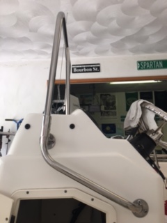

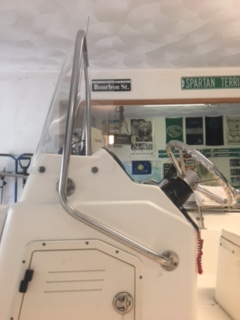

Hello, I finally took delivery of my 2003 160 Dauntless having carefully (I thought) measured to make sure it would fit in my garage. Much to my dismay and my wife's ire, I realized the boat's center console bracket and windshield sit too high to fit in my garage. I removed both to get it in so I could work on her but taking down the bracket each time I use it will quickly become unrealistic (it took two of us about 20 minutes). With that background, does anyone have an idea for a way to remove the bracket without removing the 12 bolts? Maybe cutting the bracket and putting in a quick release mechanism of some type? I would guess I’m not the only guy who has made this mistake. Thanks for the guidance!

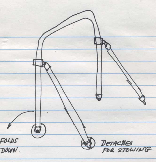

Another option to consider if only the railing is causing the problem:
--completely remove the railing and its base attachment plates; store them for possible future use;
--locate a competent local canvas shop;
--have the canvas shop bend and fabricate a new railing that is similar to the original, but will be hinged at the base so it can swing out of the way;
--the new railing will have two secondary supports, one on each side, that will clamp it in place when in the normal position; the canvas shop fabricator will figure out how to do this so that only two screw fasteners on each side need to be removed to lower the railing.
See sketch below for an idea:

Hello, I've got an update on my Dauntless railing being too tall. I enlisted the support of a friend who is an engineer and has the proper cutting tools. I have installed stainless steel couplings on the two main rail supports just above where the rail bolts to the console. It seems just as sturdy as before and now takes only minutes to remove the railing for storage in my garage. I still take the windshield down but that only takes a minute as well.

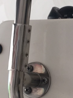

There are four allen screws in each three-inch-long coupling.
The railing meets in the middle of the coupling so two screws tighten on about 1.5-inces of railing on each side of the cut.
I fixed the bottom two [set screws]. I loosen the top two [set screws] to remove the railing on each side.
There is a center railing as well but I didn't cut that.I use a wing nut to speed its removal.
I was pleased that it seems just as secure as it did before and saves me 30 minutes of sweating inside the center console to unbolt the railing.
Below is the a good picture of the coupling. The coupling is made in 1-inch ID and 7/8-inch ID sizes. The coupling is heavy duty and solid.
The modification was simple. Cutting 1-inch-OD stainless was done with a high quality hack saw. I was going to use a power tool to make the cut but said a friend a power tool cut would heat the stainless and discolor it.
My friend taped off the spot for the cut. He cut and rounded the sharp edges of the tubing with a file. Start to finish if took about 20 minutes. The time consuming part was bolting the bracket back on in the hot, confined space of the center console, I hope to NEVER do that again. Thanks.
