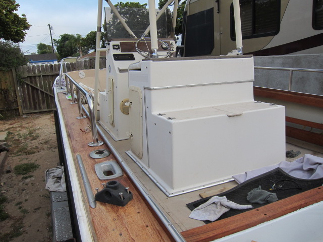

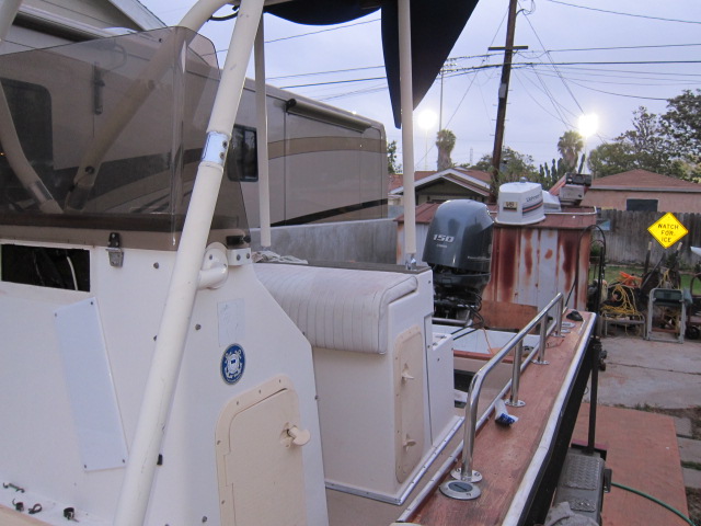

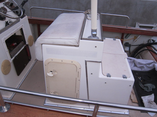

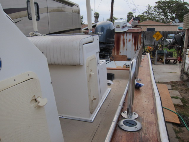

My [1987 Outrage 20] is configured for water skiing. I want to change to fishing and remove a [seat with storage console] to gain more room. [The seat with storage console] seems to be fiberglassed to plywood that is fiberglassed to deck.
How can I remove [the seat with storage console] without ruining it?

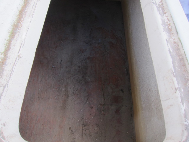

Thanks for reply. [What is to be removed is] a console seat and storage box. I looked inside and its glassed to plywood that [unclear] on top of deck.
I removed all the screws that I thought attached [the seat with storage console] to the deck but it won't budge. I may need to get out a saw and just remove the aft portion, but there would still be the plywood attached to deck.

That is an aftermarket console and leaning post.
It may be that the leaning post/storage unit is screwed into the fuel tank cover and a bead of sealant was applied around the edge. After removing all the perimeter screws try to pry up along the edge.

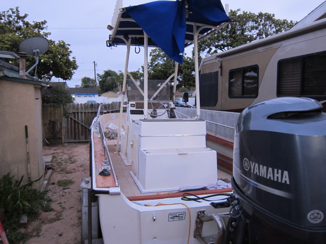

Can you post a photo showing front half of console and one showing the whole boat taken from the port quarter or off the bow?

More pics of console
