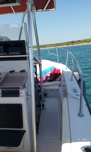

Do you need help on what it looks like? Here is one from a 1994 Outrage 24
IMG_9381 (Small).jpg (40.8 KiB) Viewed 7992 times

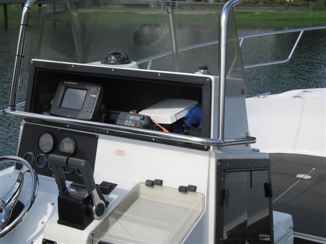

Here is a photo showing the front lip from a 1997.

Thank you! That is very helpful. It looks like it has no fold forward and is folded down on both sides, while the rearward portion folds down to possibly hand over the switches so that any water might run down aft of the switches to keep them drier? Mocking one up from cardboard is a great idea. Thank you for the solid advice. Bill
