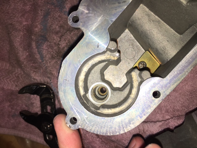

The engine is in great shape with only (roughly) 200-hours on it, and we take great care of it. Recently, we (my father) had trouble removing the "castle style" fuel filter. This was prior to purchasing the Mercury removal tool from Amazon, which I highly recommend. Basically the entire old filter was destroyed along with some of the aluminum threads on the Vapor Separator Cover. I am guessing that some of these plastic and aluminum particles have gotten stuck in one of the hoses, float kit, or somewhere else in the Vapor Separator Bowl. Most likely the float kit is jammed or broken and not shutting off the flow of fuel to the separator causing it to dump out the overflow.
So where do I go from here? I have removed the entire Vapor Separator Assembly and plan to take apart, clean well, and--hopefully--notice something obviously wrong. If not, does anyone have experience with this? Should I just replace the float kit regardless if it looks damaged/jammed or not? I also plan to replace the Vapor Separator Cover due to the damaged threads. Is this necessary even though the fuel filter can still screw in fairly easy? Should the gasket also be replaced after the cover is removed?

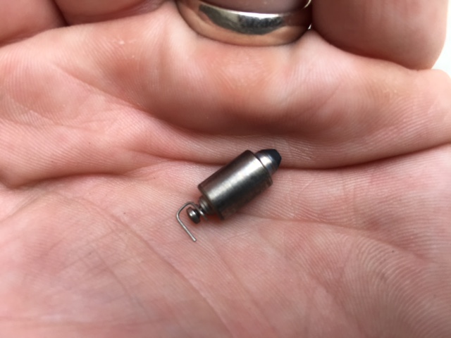

I have disassembled the entire Vapor Separator and did NOT find any significant debris or aluminum shavings. Basically nothing that is obviously the concern. Other than some minor corrosion and the Valve Kit Inlet seeming to have some carbonization on the tip, I can't pinpoint the concern. Pumps have been tested and running fine, so your presumption is correct jimh.
Is my best bet to replace the Valve Inlet Kit and pray that's the solution? Should I replace the entire Float Assembly Kit even though all the other parts are in good shape?
I also plan is to replace the vapor separator cover due to the damaged threads and also replace just the Valve inlet kit along with some of the rubber parts (gaskets/seals/o-rings/sleeve).

UPDATE 10/23/17:
Repair worked. I still can be sure the exact culprit but I'm pretty positive it was the Valve Kit Inlet.
