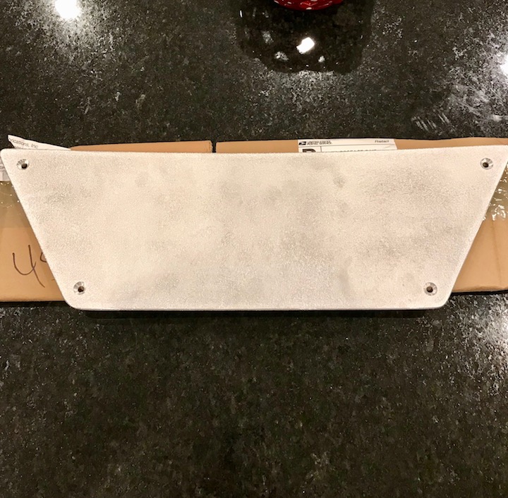

Thanks all. Managed to find Kent Fabrications. They make a beautiful piece to step up the transom top for a long shaft, but on request they can do the inside 0.25-inch-thick aluminum plate with mill finish made to fit just the inside of the transom without the step up. I hope to avoid screw holes, and will use 3M4200 to adhere the plate to the transom with a bead on the edges for a nice finish. I calculate that between the 3M4200 adhesive and the engine mounting clamps, [the outboard engine attachment to the transom] will be good for years and be attractive.

The plate was $140 total, but worth it; and I should never have to worry about it again: no rot, no cracking. Nicely rolled for 0.25-inch thick piece of milled aluminum.
[Kent Fabrications] were great. One week from contact to receipt of the transom mount. Now to the hardware store for four SS screws with the right beveled head. The plate should look pretty sweet once installed. Not to mention I can finally crank down the clamps on the outboard without fear of marring the fresh transom work.

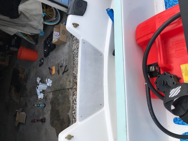

Plate all installed ... very sweet work. Re-pitched my 9.8 Tohatsu to the 5 pitch they have and finally screams at 5850 RPMs at WOT. Next up: bolting up through the transom ...

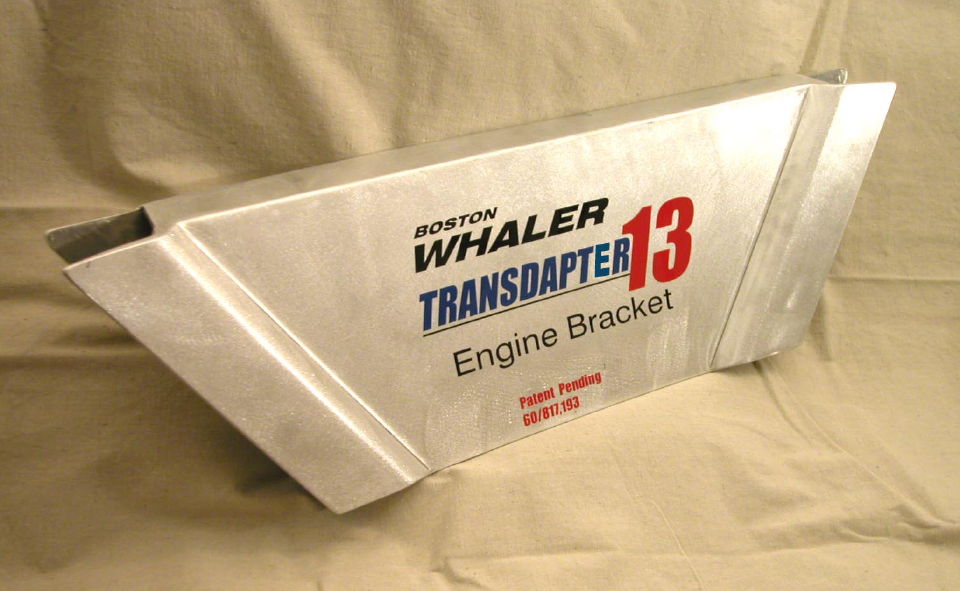

Yes, just a plate was installed to give the inside some strength. Having the motor mounts drilled and mounted through transom as I type. Bracket are usually used create a set-off off the transom and/or lift it for proper trim or long shaft. The same fellow use to do a bracket that would lift the top of the transom even to allow a long shaft installed - I think that is where you are getting "Bracket" at - see my pic a few posts above.
