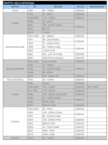

SeaStar Hydralics
Instructions: https://www.youtube.com/embed/TYFAUIMzkgs
Takt = Stroke
Art Nr = SeaStar Sylinder product number
Takt = Stroke
- Sylinder size
- seastar.jpg (113.05 KiB) Viewed 8793 times

In c.1988 and in boats from Boston Whaler rigged with hydraulic steering, the helm pump was typically a Teleflex helm without any sort of tilt mechanism. The engine actuator could have been a side-mount actuator. It is probably preferred these days to use a center-mount actuator.
Teleflex has two tiers of hydraulic steering components. The BayStar line is for engines up to 150-HP. The SeaStar line is for engines up to 600-HP. I recommend you use a Teleflex SeaStar helm pump and center-mount engine actuator. Follow the guidelines from Teleflex regarding what helm pump and what actuator to use. Alternately you could use components from UltraFlex. Work with a knowledgeable vendor to select the proper components. Buying the components in a bundle or kit may save money.
