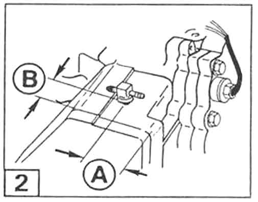

STEP 2a: Measure 2-inches (51-mm) forward from the rear corner of the exhaust manifold cover [A]. Measure in from the exhaust cover gasket 1-3/8-inch (34-mm) [B]. Mark the intersection with a center punch. [See drawing]
NOTE: Grease the tips of both the drill and tap to prevent aluminum chips from entering the cooling system.
STEP 2b: To prevent damage to the water jacket, mark an 11/32-inch (letter-R) drill bit so that the drill will not penetrate more than 1/2-inch (12,7-mm). Drill a hole through the casting and tap threads to 1/8-inch-NPT. Apply OMC Gel-Seal II to the threads of the original tee and install in hole so the water pump indicator nipple is facing the rear.
