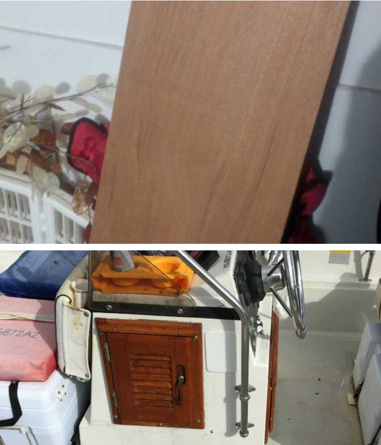

Picked up a mahogany bench from Bob in Haverhill. I pick the boat up in April. Plan was to talk to owner when I pick it up and get the varnish he used and [then I will use] the same. I also think it looks okay as is.
What you think?
I bought "z bar captains 1015." Mixed 50-50 varnish and mineral spirits for the first coat. Then sand with 220. Then a coat of 80-varnish 20-mineral spirit. The sand with 220. "Captains zbar varnish" is super expensive.
Do I need to sand between ever coat?
I plan to do seven coats.
I know [little] about woodwork. It's all new to me.
The sponges to apply [the varnish] were $3 (each), and I need to take two days to do one [coat] because I do one side, wait [for the varnish] to dry, then flip over [the work] and do another side.
If I do seven coats and need a brush for every side that is 14 brushes. Should I do something to preserve the foam applicators between coats ?

Looking at the console door hue I would have gone with Interlux Schooner Gold as that will bring out the teak the best. Z Spar is great varnish also but doesn't give you the golden teak hue. I recommend the Schooner GOLD.
Yes you must lightly sand between coats and I recommend WET sand with 220-300. This will give you the best adhesion between coats.
See INTERLUX VARNISH GUIDE for good general instructions. Yes foam brushes can be used but make sure the are of the higher density foam kind(quite often grey and not the black).

Achieving a perfect match in color and tone is really not possible. I suggest that you save yourself the stress of trying to do that.
Thinning varnish for the first two coats is the correct course for filling pores in the wood. Alternatively, you could use a sanding sealer.
Then apply full coats and definitely sand between coats, using 220 grit, with 320 grit (wet or dry) before the final coat.
Many choose foam brushes for ease and convenience, but high quality white china bristle brushes are traditionally viewed as unsurpassed in smoothness of the finish.

I used painting cones to try to paint both sides and the side facing the floor got bubbles. I think from gravity. I sanded that side and the bubbles now seem to be gone with another coat. I am only going to do one side at a time. It is going to be long to do the seven coats.

I would never try to assess the color match of anything based on random digital images. The only way to compare hues is by direct, side-by-side comparison by eye in the exact same lighting conditions.
Also, I don't believe there is any way to assess the future hue and lustre of a piece of unvarnished wood by comparing it to some present wood with varnish that has been subjected to several years of weathering.
If you are obsessed with obtaining a match to the existing varnish, then completely strip off the all the existing varnish and start over with bare wood on everything. Use the same varnish and the same application method.
Also, SPONGES are never used to apply varnish. Usually one uses a foam brush. You can buy foam brushes anywhere. If you buy them at a ship's chandlery you will probably pay the highest possible price. Buy them at a big box hardware store for about 99-cents.
